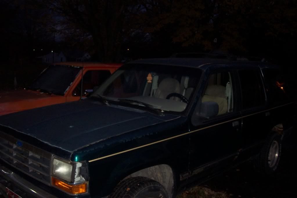

Well To day I picked up this.

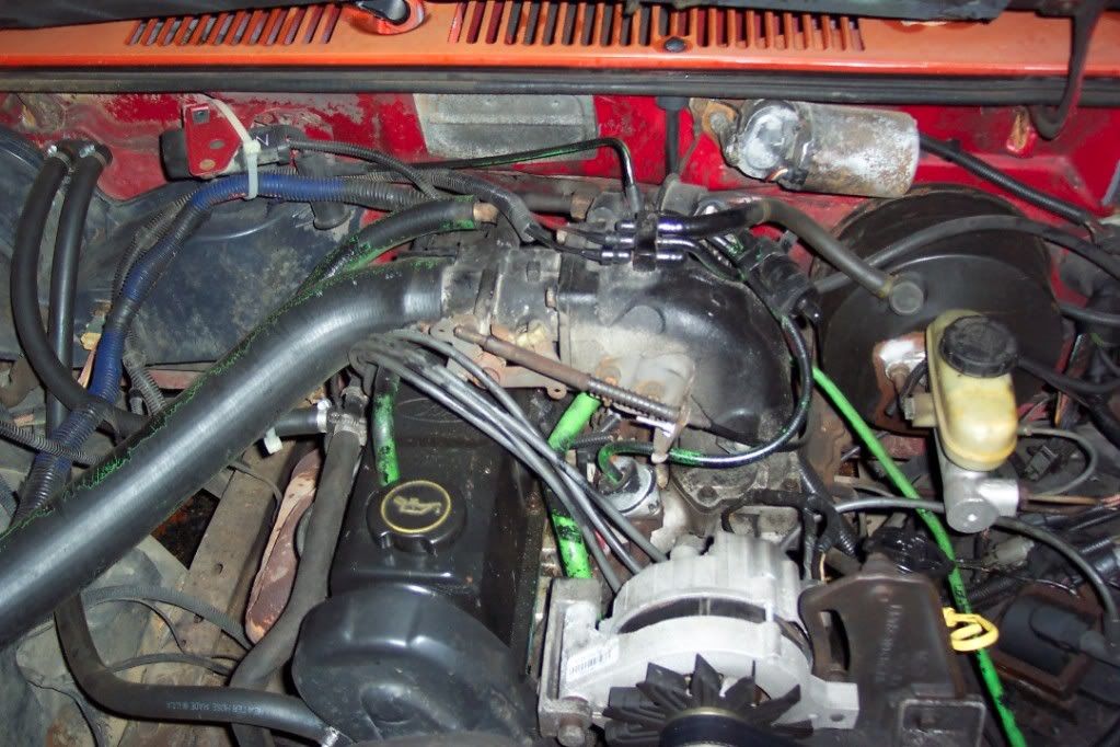

and it has this in it

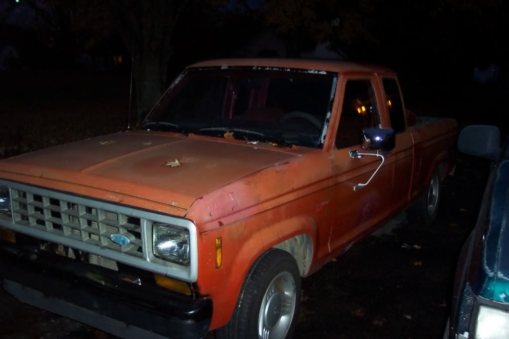

that will be put in this
to replace this

The Explorer is a 92 and been ragged out on the inside, but the engine runs and doesn't smoke, the tranny is bad, all it has is reverse, no forward gears, that's those autos for you.
I'm going to try and get the engine out and get the Explorer strip of all the good parts before my wife kills me for taking up so much space in the drive way, I'm going to put the rear end from the Explorer in the Ranger, and if I can I'm going to try and trade the Explorers front axle for a set of drop beam for my Ranger, any body close want to do some trading, look me up.
I'm also going to look for me a 2wd 5 speed tranny for my Ranger since it is already a 5 speed, and I guess sell or trade the auto and transfer case for something, maybe a set of nice wheels.
