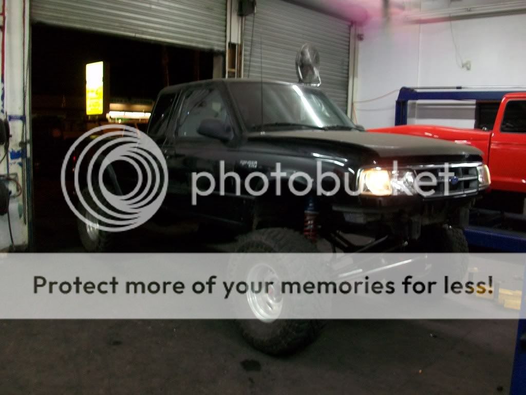

after all that fun... I went from this:
To This:
To This:
