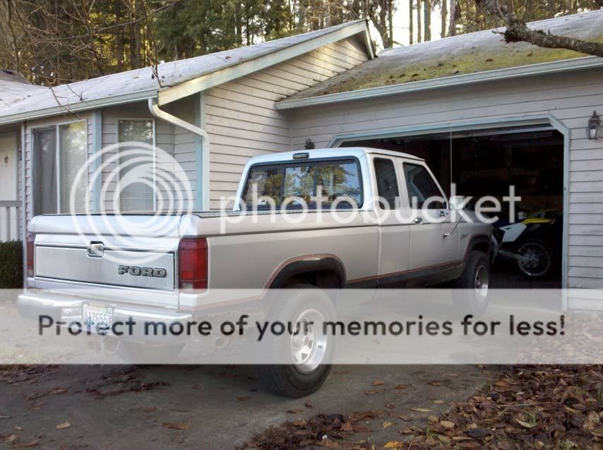

So the build begins gents. Here are some pics for refference. I'll be posting lots and lots of pics as the build progresses. Tomorrow I'm going to pick up a Dana 35, to replace the 28 that's in it. I found it on craigslist for $150 including manual locking hubs:headbang:
