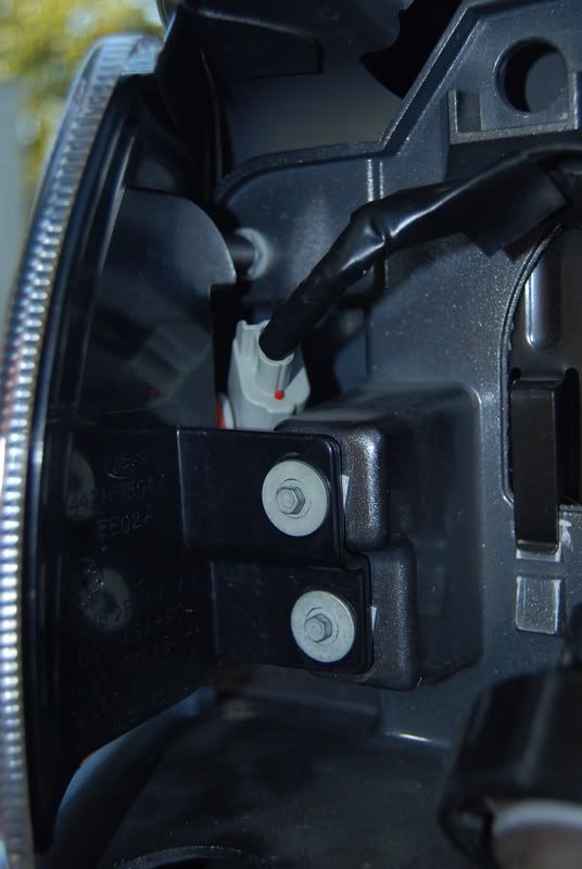

Your head light has 2 clip to pull up on
Then unscrew these 2 bolts and your corner lights are free
