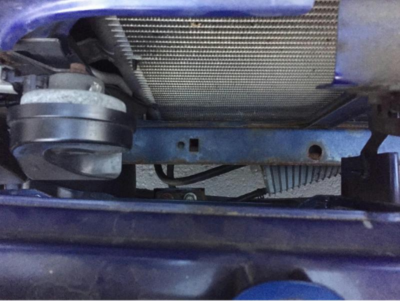

* It must be noted that in researching how to do this, apparently some trucks did not come with holes drilled in the front cross member for tow hooks. I don’t know what years, trims, etc. that got the holes or not. The simplest way to determine is to actually look at your cross member. In the junkyard retrieval section below, there are pictures of the holes on the member. If your truck has the same hole patterns, you most likely have the correct holes already.

1. Looking to either side of your license plate, there will be open sections. This is where your tow hooks will bolt in. Lay down under the front of your truck and hold one of the tow hooks in place (or have a helper hold it in position for you!). Start by threading on the bolt that sticks out of the cross member. Don’t crank it down or use any thread locker yet! Just enough thread to hold it in place. Now you don’t have to worry about holding the hook in place while you work on it.

6. Now, repeat for the passenger side. … See it yet? The transmission cooler is in the way! This is what makes the installation a little more difficult as you have to unbolt the transmission cooler and shift it out of the way. So first, we are going to move it out of the way.
7. Using the 8mm socket and wrench, unbolt the bolt that is located under your horn bracket. Be aware that the bracket that is secured by this bolt might come out. It is supposed to be secured to the tranny cooler by rivets but mine were broken, so heads up.
8. There are two bolts in the bottom of the cross member that hold up the tranny cooler. Remove these as well. Have a helper hold the tranny cooler for you or be ready for it to drop down on you.
9. You can now carefully maneuver the transmission cooler out of the way and proceed to install the other tow hook like the first.
