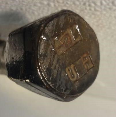

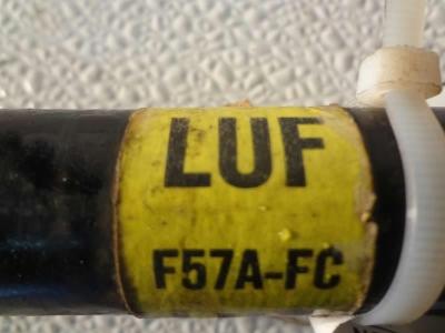

Torsion Bar Sticker / Stamping:
The torsion bars have a sticker on them
And are stamped on the end. This is a 'F' code torsion bar

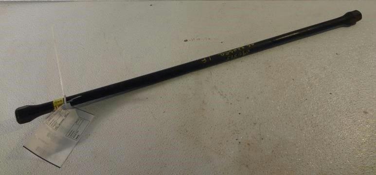

Torsion bars - Measure the diameter:
(Torsion bar code / approximate bar diameter)
1 / 1.09 inch (strongest)
B / 1.06 inch (mid level)
F / 1.03 inch (weakest)
