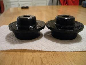

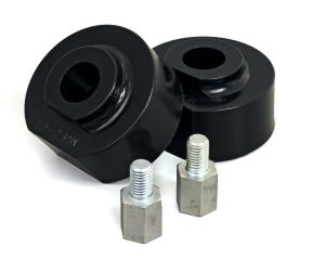

Aftermarket 2-Inch Spacers:
No Metal-On-Metal Contact - Daystar uses Polyurethane material in its Leveling Kits for a reason: It's an insulator. It absorbs the Noise, Vibration, and Harmonics (NVH) that come from the suspension and avoids transmitting them to the passenger compartment.
These fit the 1983-1997 Ford Ranger, and 1984-1990 Ford Bronco II.
  • KF09108BK fits 4x4
  • KF09101BK fits 2WD
These are offered from Daystar (4x4 Model) (2WD Model).

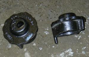

Factory Spacers:
Ford has used a metal factory spacer in the F-150, and many enthusiasts have used them in their Ranger and Bronco II for lift.
These will work on 1983-1997 Ford Ranger, and 1984-1990 Ford Bronco II.
Click HERE for more information.

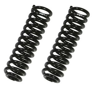

Leveling Coil Springs:
Skyjacker offers a 1-1/2" to 2" Inch (expect 1-1/5") leveling coil for the 1983-1997 Ford Ranger and 1984-1990 Ford Bronco II.
  • PN SKY132 (for all except 4.0L and extended cab)
  • SKY132X (for 4.0L and extended cab models)
Superlift offers a 1.5 inch leveling kit for the the 1989-1997 Ford Ranger. Their kit involves the new front springs along with shocks and alignment bushings.
Superlift also offers just they 1.5 inch front springs as P/N 128.
