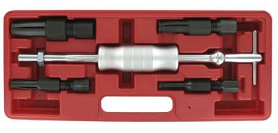

    Having the right tool is key. Autozone has a blind hole puller set that you can buy or rent, Harbor Freight has a similar tool found HERE.
    (blind hole puller - Use for 2.3l with the bearing in the crankshaft)
