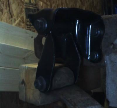

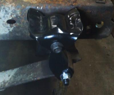

I just replaced both rear shackles, both rear shackle brackets, and the bracket on the front of the passenger rear leaf spring.
I am posting this to help out anyone who has trouble finding the shackle parts. For starters, you can get everything you need at NAPA and Oreilly's EXCEPT for the front bushing on the leaf spring.

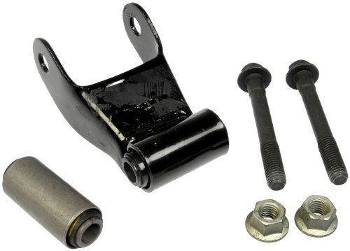

The bushing from NAPA and Orielly's is too small. It takes a split bushing, which I got from my local ford dealer. The brackets and shackles are like $20-$30. The bushing was $30. I got my shackles from Orielly's because they were cheaper, but Napa has them too.
(Dorman 722-001 Shackle Kit)

Shackle Kit 722-001 (Dorman) 722-001 (Dorman) 722-001 (Dorman) NOE 6504095 E6TZ 5776-B

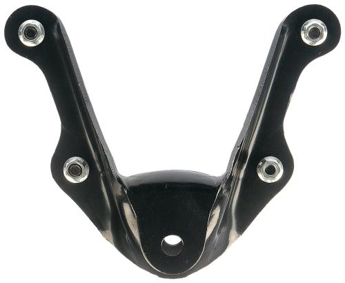

Rear Spring Hanger 722-010 (Dorman) 722-010 (Dorman) 722-010 (Dorman) NOE 6504109 4L5Z-5775-AA

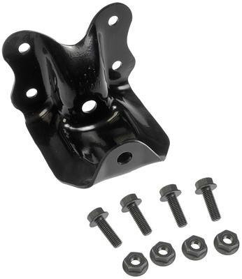

Front Spring Hanger 722-011 (Dorman) 722-011 (Dorman) 722-011 (Dorman) NOE 6504116 F57Z5775A

(Dorman 722-011 Front Spring Hanger)

I replaced my shackles and hangers on the rear of the rear leaf spring. I used Dorman part # 722-010 and #722-001. they are less than $100 for all 4 pieces. They worked great. they come with everything you need. A helpful tip is it is much easier with the bed off.
