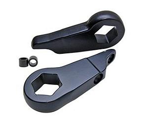

ReadyLift® Torsion Keys are engineered to provide the CORRECT amount of “clocking” to provide the lift necessary to level the vehicle without compromising the ride quality and working within the factory geometry specifications. Our keys provide the ability to apply specific force to the rotation of the torsion bar to establish the desired lift while allowing the torsion bar to be able to rotate during downward suspension cycles. Our Keys are designed specifically to accommodate what the owner wants as well as what the suspension needs in order to operate correctly.

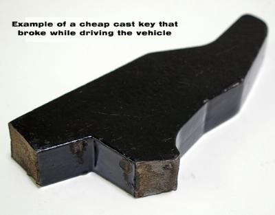

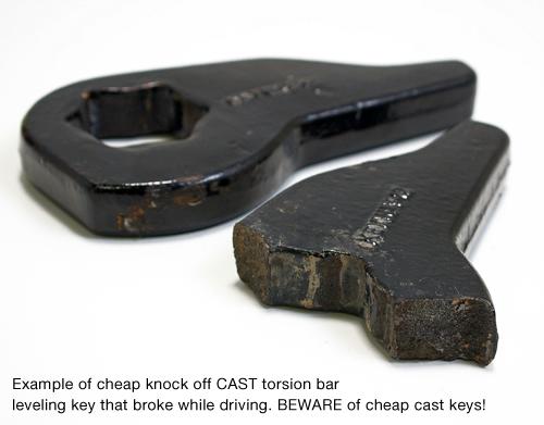

ReadyLift® Forged Torsion Keys are designed beyond the OEM cast key requirements (25% stronger) because increasing the rotation of the torsion bar also increases the torsional energy and force. Cast keys often cannot handle these additional forces and will FAIL. It is not uncommon for an installer to discover a dangerous surprise when trying to load a cast key that is most likely incorrectly and haphazardly clocked. Installing a torsion bar leveling key takes incredible force, something many cheap cast keys that can be found on the market simply cannot handle. Some cheap cast keys break during installation or while simply driving down the road, both of which present dangerous complications to both life and vehicle.
(Beware when buying cheap or no name ebay kits)

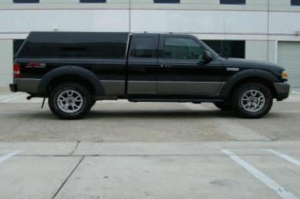

I noticed zero difference in the ride after I installed them. Pretty Pleased with the results. 2009 Ford Ranger Sport 4x4 4.0L - ReadyLift 2.25' Leveling Kit.

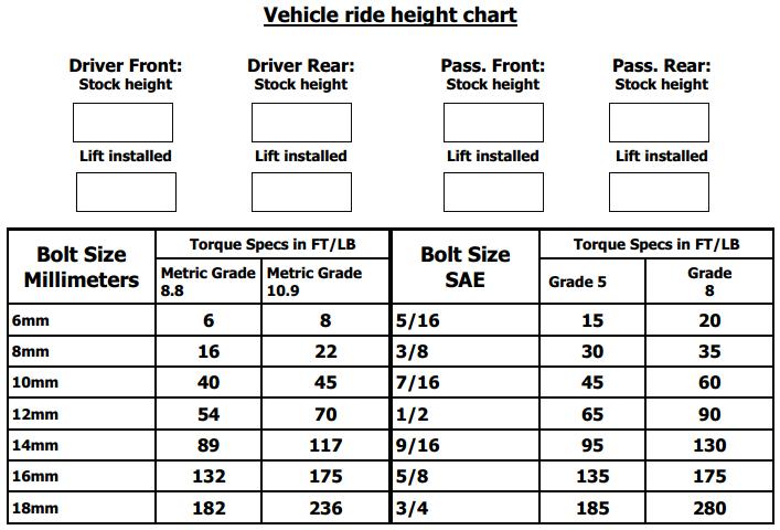

Suspension components that use rubber or urethane bushings should be tightened with the vehicle at normal ride height. This will prevent premature wear or failure of the bushing and maintain ride comfort. Larger tire and wheel combinations may increase leverage on suspension, steering, and related components. Due to payload options and initial ride height variances, the amount of lift is a base figure. Final ride height dimensions may vary in accordance to original vehicle ride height. Always measure the vehicle ride height prior to beginning installation.
Unless otherwise specified, tighten all bolts and fasteners to standard torque specifications listed within the OE Service Manual, or as referenced in the torque specification list provided in these instructions.

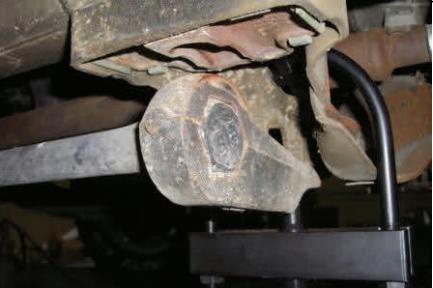

Raise vehicle and support frame with jack stands

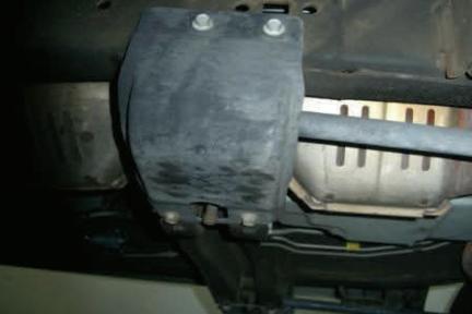

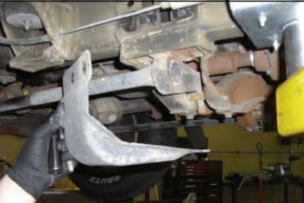

Locate cross member cover and remove bolts
Cover will expose torsion keys
Remove torsion key adjuster bolt

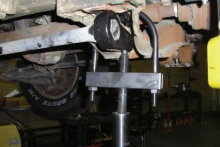

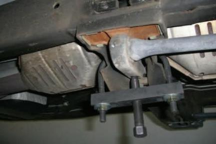

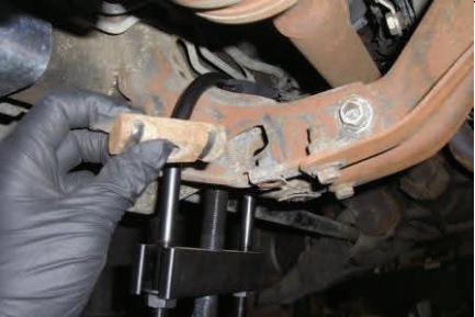

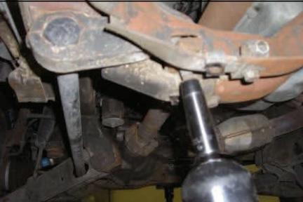

Place torsion bar unloading tool adapter above cross member
Attach u-bolt over cross member and install tool

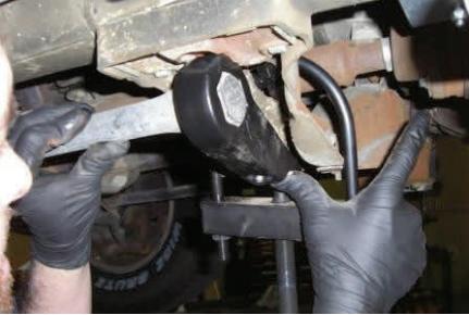

Adjust tool enough to remove keeper block

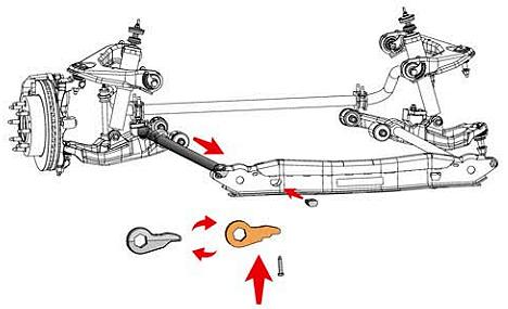

Unload tool and torsion bar will lower, remove torsion key
Install new torsion key and reload tool
Adjust torsion key tool enough to replace keeper block
With the new torsion keys installed, reinstall adjuster bolt into torsion key keeper block.

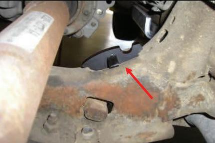

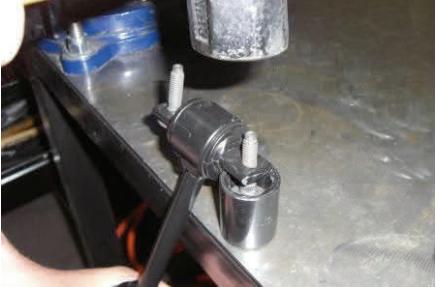

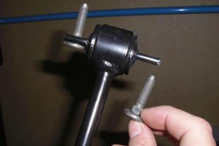

Remove the front shocks from vehicle in order to perform the next few steps. Use caution to avoid damaging shocks.
Hammer out OE mounting bolts

Post Installation Warnings: Once the vehicle is lowered to the ground, check all parts which have rubber or urethane components to insure proper torque. Torque wheels to factory specs. Move vehicle backwards and forwards a short distance to allow suspension components to adjust. Turn the front wheels completely left then right and verify adequate tire, wheel, brake line, and ABS wire clearance. Test and inspect steering, brake and suspension components for tightness and proper operation. Inspect brakes hoses and ABS lines for adequate slack at full extension. Failure to perform the post inspection checks may result in vehicle component damage and/or personal injury or death to driver and/or passengers. Test drive vehicle and re-check the torque of all fasteners and re-torque wheels on vehicle. Re-adjust headlights.
