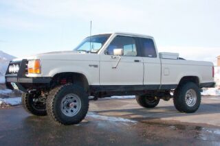

A few things have changed since that day at the dealer.  I immediately started dreaming up custom add-ons so that I could make the truck ‘mine’. I had big dreams on a small budget.  It worked out that I ended up just fixing all the minor problems with it first before I got to do any mods. The famous tranny rebuild, ignition module, water pump, rearend, fuel pump, etc…All of this, a perfect learning experience.
Then the mod time came.  I found that the 2.9 is not the most powerful of engines so I had to find some more horses in there.  I started with JBA headers, a Dodge Neon cold air intake, and worked on porting an intake plenum that I had laying around.  I also made a custom dual exhaust system.

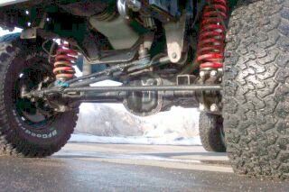

Then came numerous minor additions and some major ones including my favorite, the Early Bronco Solid Axle Swap.  I used a Dana 30 out of a late 60’s Bronco, they are cheap, strong enough for mild off roading and a lot of them come with 4.10 gears, which this one did, so I set out to get all the parts for the swap, and as luck would have it, I had a lot of friends that either had the parts that I needed or a way of getting them.   I installed the Chevy disc brakes, which was the most involved part of the entire swap.  I already had a lift on my Ranger and I didn’t have the money to get new springs so I fabbed a bracket that would hold the Ranger springs on the Bronco axle, I also had to fab the radius arm brackets and trac-bar bracket, and like anyone that has done the swap, I went through several alternative designs, and I am hoping the present one is a keeper.  I am pleased with the swap but soon I will be installing ‘suicide springs’; the installation of softer Jeep coils instead of the stiff Ranger TTB coils I currently have.

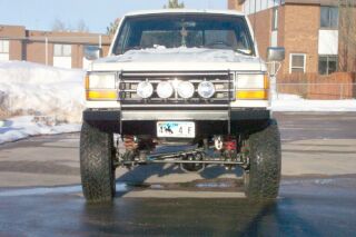

I have wanted a heavy duty off road bumper for some time now but found that there isn’t a manufacturer that makes a bumper for a Ranger that I liked and I thought about adjusting a Cherokee bumper to fit, but I still wasn’t happy with any designs out there, so….., I made my own.  The main frame is made out of 1/4 “ steel with the ‘body of it made out of 1/8” steel.

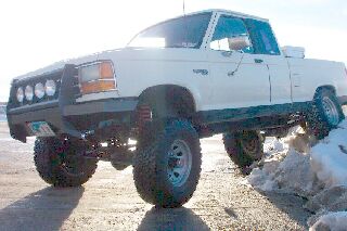

I didn’t like the docile, next door neighbor look of the truck, so I brainstormed about something that would give it a little ‘meaner’ look.  I came up with a 2” Cowl hood.  I cut the hood, braced it and ‘glassed it, and that is where I am at now.  The hood is still not done but it will be soon, and that will just lead to the next mod down the line.
