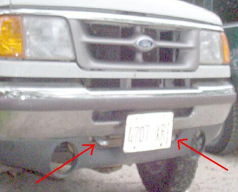

This is how the tow hooks will be positioned when finished:
97 hooks.jpg (27801 bytes)
You can see the tow hooks stick out between the opening in the fog-light valance on both sides of the license plate.
