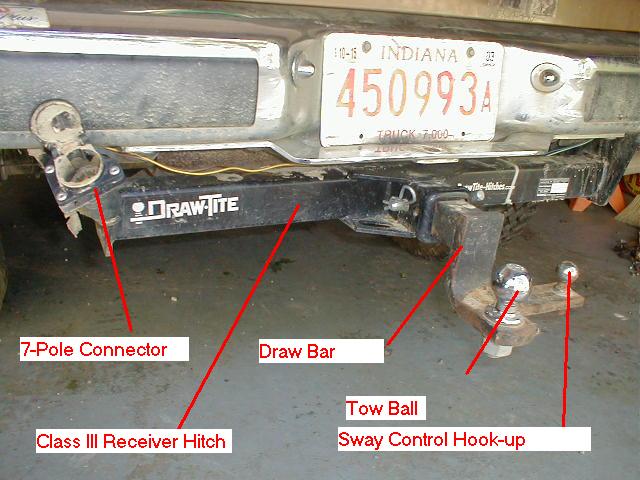

Generally, the factory step bumper is rated to pull a trailer weighing up to 2,000# with a maximum tongue weight of 200#. If you tow anything exceeding either figure, you will need to get a frame mounted receiver hitch installed. though the bumper is frame mounted, it is of much lighter construction and bolts only to the very end of the frame. The receiver type frame hitch (also called a receiver hitch because it is simply a receiver for a draw-bar--the thing you bolt the ball to) bolts onto the last 18" of frame, doing a lot better job of distributing the trailer load.
The Owner's Guide recommends that any trailer over 2,000# be used with a weight distributing (equalizing) hitch. The function of a weight-distributing hitch is to lift up at the junction between truck and trailer in order to force some of the tongue weight onto the front tires of the truck. This prevents the rear of the truck from squatting. More importantly, it keeps the trailer from see-sawing and unloading the front tires, reducing control. The active ingredient of the equalizer hitch is a pair of spring bars that are tensioned in a way that attempts to close the bottoms of the truck and trailer together like a folding knife. This adjustable mechanism actually lifts the tongue weight off of the rear suspension and shifts it onto the front. It is important to realize that simply adding leafs or air bags to stiffen the rear suspension is not a cure for excessive tongue weight. "Helper springs" may level the rear of the truck, but they do not shift weight to the front tires. The steering and handling issues will still be present, if not multiplied. I personally believe that an equalizing hitch isn't really needed until about 3,500# with these trucks, but if you have a rear sag problem then you need it.
Another item worth noting if you are having trailer control problems is a sway control. This device is simply a friction brake that resists articulation between the trailer and truck. it does a great job of keeping the trailer straight in wind or bumpy roads and I especially recommend it for big boxy trailers.

There are a great variety of connectors. I have a couple of adapters in my door pocket because I often borrow or rent trailers. The most common connectors are either a 4-flat or a 7-round. I have the 7-round on my truck because it is the most common RV connector. It contains the same four wires that the 4-flat uses (left and right signals, brakes lights and ground) plus includes a wire to charge the trailers house batteries, a brake wire and an auxiliary circuit that could be used for anything you want. Some people use it as an extra ground because of the high current a travel trailer can draw using the truck alternator to charge the house batteries. Other connectors I am familiar with are 4-round, 5-round, 5-flat, and even a 6-round and a 9-round. The 9- round has three auxiliary circuits.
One thing to think about when wiring your truck--don't! Any vehicle made in the last 15 years will have a simple plug-in harness that keeps you from having to splice into the vehicles harness.
