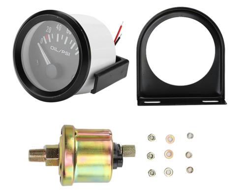

So, I bought a kit for around $15 at a discount auto parts store and here is what I got with it.
oil pressure gauge and sending unit
Oil Pressure Gauge & Sending Unit
I chose this one because it was only a couple of bucks. The way I see it is that it is cheap insurance. This gauge will allow you to monitor the oil pressure at a more accurate level then the factory “Ya I have pressure, crap now I don’t”.
