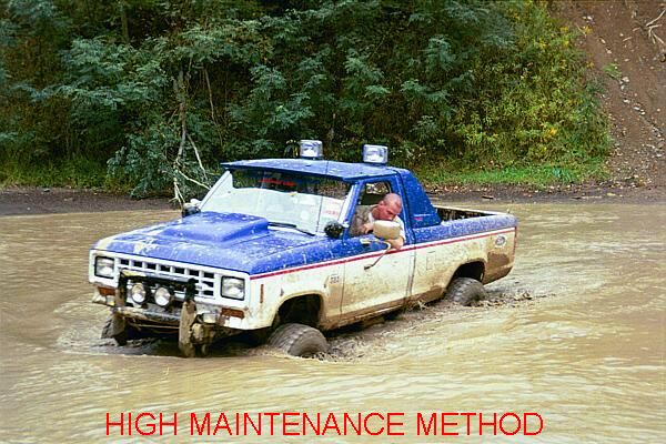

I’ve always felt my Bronco II has led sort of a charmed life.  No matter what I do to it, or how often, it always seems to start at the first twist of the key; lurch happily down the road as I scull through the gears and cheerfully endure the bumps and bruises of it’s weekend life of chores and recreation. So imagine my surprise when I have a tire off for something or another and find the drivers-side wheel bearing loose; the locknut still tight as a greedy clam.
So I decide a ten degree wheel bearing wobble is probably sort of unsafe and pull the thing apart.  I don’t have much hope it’s just loose, but maybe I can get it snug enough to make the Snowball run with it.  No damn fear: I’m sitting there with a handful of rust-corroded rollers and the outer cone in my hand thinking maybe, just maybe, I should have inspected it after my umpteenth jaunty splash through the creek.  So chalk me up for a new disk/hub, wheel bearing set and inner seal. That should do it, right?
