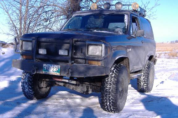

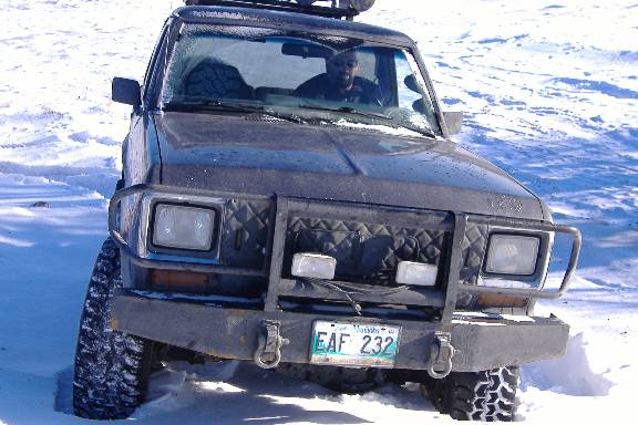

A new front bumper was made and installed.

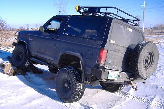

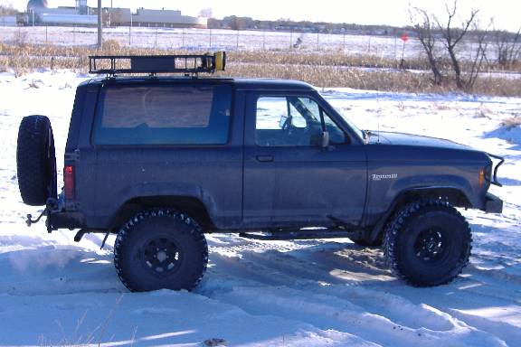

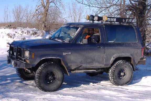

As the Bronco stayed this way for a few months, the talk of a few more inches of lift were being tossed around. Well it so happened I had a set of 4” lift brackets I had removed off my truck that I sold him. So within the coming weeks it was decided that it was time. I helped out with the 4” lift install. After a day of wrenching the results were seen and they were liked. Just too bad the 31’s now looked smallish. A friend of his had an interesting idea and chopped up a stock BroncoII emblem for the extra II’s and they were installed after the factory badges. The Project now had a new name, “Bronco III.”

After coming out to help me with some of my projects it was decided that my 33” tires were going to be on loan. After installing them minor fender trimming was involved. And it sure made a difference. There was light, and the BroncoIII was starting to become what John had envisioned.

Another weekend was set aside for the install. The newly rebuilt 4.10 diff for the D35 was done and it was time to swap. Everything went without a hitch. The front coil springs were upgraded to newer 4” Skyjackers. At this time the Drop plate bracket used on the 4” lift looked as though it was going to interferer with the D35 housing so a new 1 piece bracket was installed to eliminate the drop plate. Now the D35 had lots of clearance. The front sway bar was eliminated at this time also.
