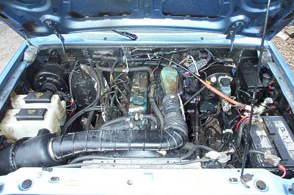

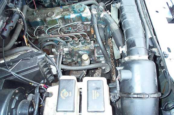

Because under the hood of Andy's '97 2wd Ranger is a
naturally-aspirated, indirect injected Nissan SD-22 4-cylinder diesel
engine pulled from a 1982 Datsun pick-up. About a 90hp trim off of the
stock 3.0 V6 that came in his truck. And why? It's all about gas
mileage, Bubba. Try 37mpg!

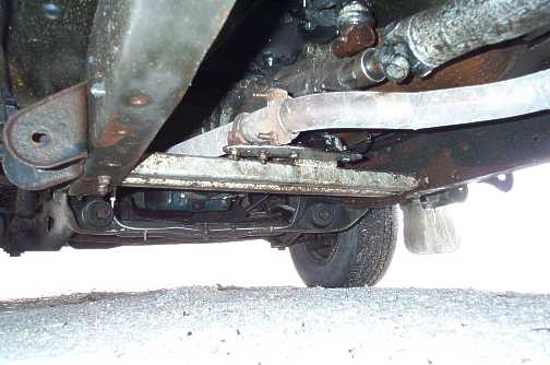

through Andy's description of the swap, it seems pretty simple. But
there are a couple of indications that his fabrication skills are well
above average. For instance, he machined, welded and balanced his own
driveshaft. That is something $100 or so would take care of at a
driveshaft shop, but that is a lot of gallons of diesel oil if economy
is your goal. So he did it himself. The rest of the swap is just careful
fitting and clever thinking. Nothing spectacular.

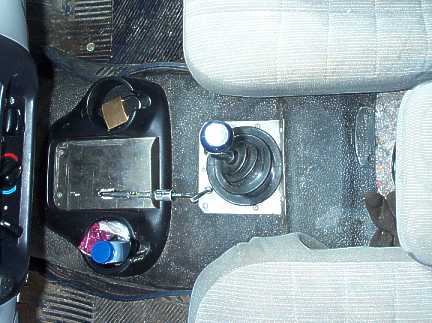

Since
the Datsun transmission placed the shifter further back, Andy trimmed 20
off of his 60/40 seat and made a plate for the new shifter. The hole for
the original shifter was plated up and a mechanical fuel cut-off lever
was installed there to shut down the engine. All of the Ford gauges now
sense the Nissan engine's vitals and the Ford clutch master now operates
the Nissan clutch slave. He was forced to give up his power steering in
exchange for a manual steering box as there was no way of putting the
pump on the diesel. No big loss on a truck with functionality as Job
One.
