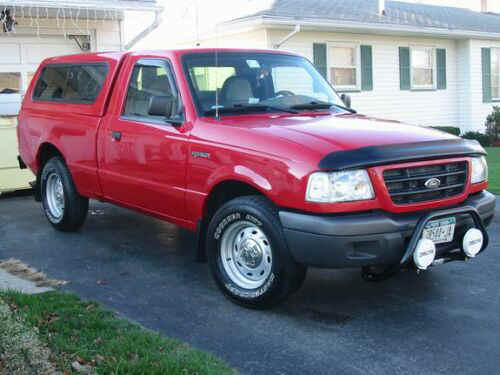

Well let’s see, what do I have to start with? Well, my truck is a 2WD, your basic run of the mill light pickup truck, nothing special. Well that rules out trying to keep up with the big boys. Maybe it’s got a limited slip in the rear, that’s a plus. If not it’s not an absolute requirement and can be fixed later, or you can always go the lunch-box locker route. Some more aggressively treaded tires need to be found. You know you were looking for a good excuse to get better tires anyway; we knew that was going to happen.

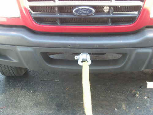

Why not indeed, if you can find one for your year truck it’s not a bad alternative to the lack of tow hooks. In fact a hitch might even be a better choice than factory installed hooks. Consider if you will the mechanics of getting unstuck. Your truck is in the mud up to the axles. You’re spinning the heck out of the tires but getting nowhere fast. Its time for a tow, or a winching. So you get out of the truck making a mess of your sneakers or boots, all the while hoping you tied them tight so the mud doesn’t suck them off on you. You get out the tow strap and toss it to your buddy who’s laughing at you the whole time, but still willing to pull you out if he can. You wade through the mud to the front and hook up your end to a hook and climb back into your truck.

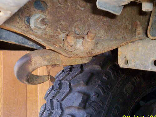

Now what happens, you hit the gas and he tries to jerk you out. But how is he jerking you out? You have that strap on one of the tow hooks, right? So his truck is putting the entire force of his truck and the drag of all that mud through one frame rail. Yep all through one frame rail, we won’t mention that that macho looking tow hook is only held on by two bolts. Their good bolts but there are only two of them and they have been “jerked around” before. You wonder how much of this kind of nonsense will they take and for how long.

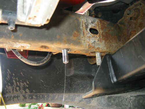

OK, so let’s look at the trailer hitch. It’s bolted to BOTH frame rails, it may still only have two bolts in the rail, but there are two rails, and that means four bolts. Hitches have at least four bolts holding on, and if you’re worried about it you can always add another. The mounting plate is long enough so that there’s plenty of room for at least one more per side. Now when your laughing buddy hits the gas to jerk you out of that hole he will be putting all the force through “BOTH” rails equally. So at least you won’t have to worry about everyone laughing at you as you drive home with your poor truck dog tracking down the street because one frame rail is now in front of the other by a quarter of an inch.

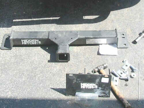

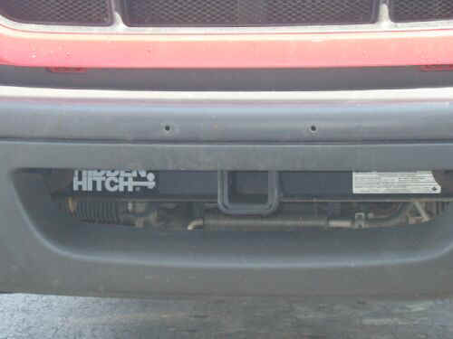

I looked around until I found a hitch, 2 actually, from Reese and Hidden Hitch that will fit my truck. The Reese model comes with the tow rings already securely welded in for you. But there is a catch. On the one they make for my truck the receiver portion of it hangs below the bumper and valance significantly affecting your approach angle. The Hidden Hitch on the other hand, while it doesn’t have the handy tow rings it doesn’t hang below the valance either. In fact it exits just below the bumper behind the plastic license mounting plate. This is a much better arrangement as it not only doesn’t impact your approach angle but it also puts a substantial chunk of steel between anything in front of the truck and the bottom of your radiator. That’s not a bad thing at all, if you ask me. For you guys in states that require a front plate there are adaptors to replace your old mount.
