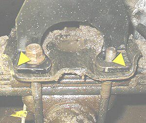

Once we removed the u-bolt nuts and the plate fitted on, the necessity for a modification was obvious. The plate is very slightly too wide at the bottom to sit flush on the spring retaining plate. This is a simple problem and took only a few minutes with an angle grinder to bevel the bottom front and bottom rear edges.

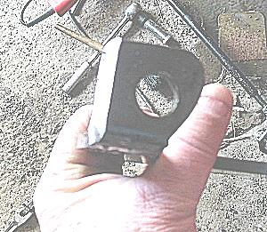

We discovered another “problem” when Dave tried to install the forward mounting plate. The older Rangers, this kit was originally designed to fit, had their spring perches riveted in a “V” angle. The forward plate has a bend in it to accommodate this angle. On the newest generation Rangers these spring mounts are oriented vertically like a “U”. The newer shape prevents the bar from aligning properly with the bushings

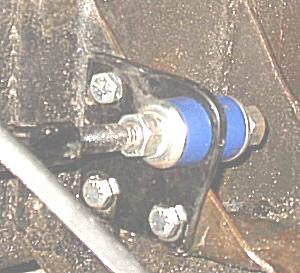

Again Dave with his engineering wizardry came to the rescue. A large hammer and the back of an even larger vise proved that the hammer is mightier than a bent plate. Couple of healthy whacks and a couple of lighter tuning smacks and voila the plate is flat. It’s now at the proper angle for the bars’ bushings to go through.
All together it only took us about two hours to install the bars. The tools needed are commonly available. Most of us have them or can easily find them. The traction bars went together very simply. By doing the grinding and bending ahead of time you could probably do the entire job in little over an hour by yourself. With a friend I’ll bet you can do it in lots less time.
