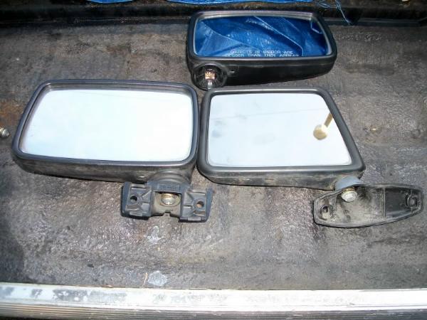

A side by side of the ranger style mirror (right) and the trooper mirror (left).
The Ranger mirror in the picture is a cheap parts store replacement with a brittle plastic base which I borrowed for this picture. The mounting bases are not spaced the same and the trooper mirror is a bit bigger than the rangers.

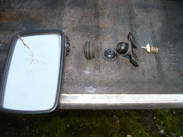

An exploded view of the Trooper mirror, you throw away the black plastic piece next to the base and the base goes in the trash with it.
