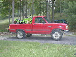

A few months ago Jim Oaks sent out a request for ideas on a no-holds-barred Ranger build-up. Toward this end I decided to take a look at my truck and see what improvements would make it, for me, into the perfect vehicle.
First, lets look at the Ranger’s inherent qualities. It’s Twin Traction Beam (TTB) suspension with it’s long axle beams allows a respectable amount of wheel travel, even in stock form. I have measured 4” of down-travel on my stock truck, which is about twice the travel I measured on an IFS Nissan truck. The Ranger is compact which assists in its off-road maneuverability, but can also haul a decent sized payload with ease. For those desiring a little more performance, the Ranger is a fairly simple vehicle to work on with it’s open-section frame and conventional construction. It’s good aftermarket support and high degree of interchangeability with other Ford vehicles enables the builder to assemble a tough truck without requiring custom components.
When planning the build up of my truck, I wanted the best of both worlds: maintaining the functionality of my truck as a truck while increasing its off road performance. My truck sees a fairly hard life. I burn about 3 cords of wood each winter and all of it is cut and hauled by me. This involves climbing and descending steeps hills and bouncing through fields with a half ton or more of wood in the bed. Additionally, I pull my 16’ travel trailer around a four-state area and even occasionally hook a car trailer to my truck. As my daily driver the truck has to dependably see me through about 30 miles per day in rain sun and snow. And: it has to survive the trail.
The trail I frequent is a 2 mile section of road that the county stopped maintaining in 1953. It has one large rocky hill, huge ruts and drop-offs, numerous streams crossing it and lots of frame bending gullies to traverse. It is the gullies that are the problem. They must be crossed at angle because the entrance and departure angles are excessive for hitting them head on. This means that a very flexible suspension is the primary improvement I require. Running a close second is simple ground clearance under the axles. My wheelbase is short enough that a skid plate or rocker strike is very rare, but there are occasions where the front differential axle beam drags along the ground if one side of the truck is riding in a rut.
