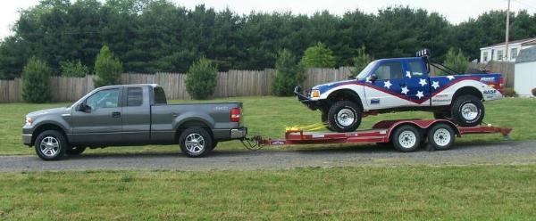

Balance - Load balance is important. Have a minimum of 10 percent of the total weight on the trailer’s tongue or tow rig’s hitch. This is the secret for a good, straight pull. For example, if your trailer and cargo weigh 6,000 pounds total, then at least 600 of that should be at the trailer’s tongue. Generally speaking, if you drive your rig onto the trailer, it should be just about centered over both axles. The engine weight up front will most likely offset the equal balance and put enough weight forward. It may take a couple of tries to figure out the trailer handling and how level the tow rig sits. Once the location is figured out, be sure to mark the spot for future reference, in case you forget it.
My standard cab and extended cab Ranger's each have a different point that they sit on the trailer. I know when I have the desired amount of weight on the rear of my F-150 (tow rig) because the rear will sag down a little.

The straps on the front of my rig actually run around the square tubing on the front of my trailer. The tubing has round edges so there isn't any 'corners' for the strap to rub on and cause it to get cut. I use two straps on the front of my Ranger and both are attached to the front axle at both ends.
