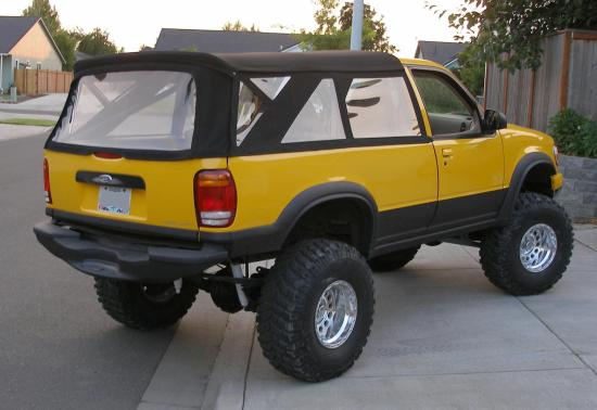

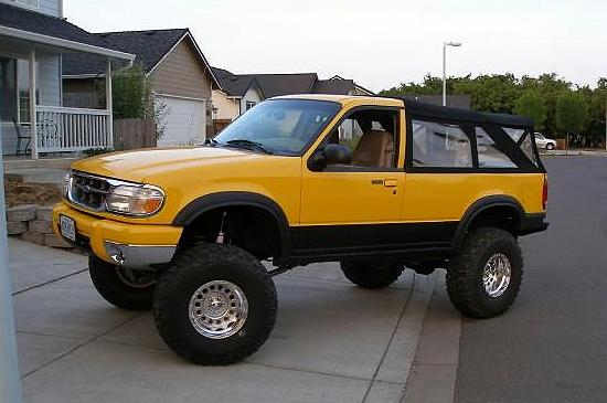

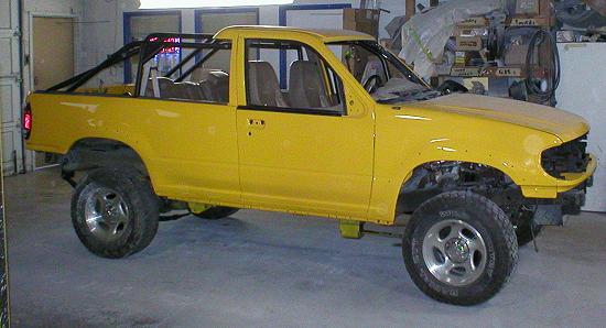

What you see here is a 1999 Ford Explorer with a factory 5.0L V-8.

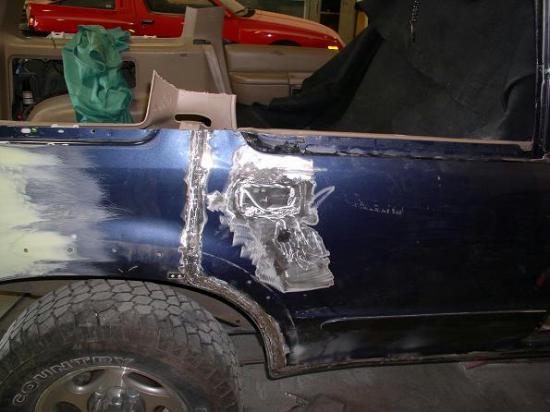

The vehicle had been involved in an accident and the roof was smashed. The roof was removed and the rear doors were welded shut. The gaps around the doors were welded in to give it a clean look.

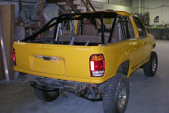

Since the roof was removed, the rear was treated to an interior cage to protect the occupants. A removable custom soft top was then made to enclose the back.

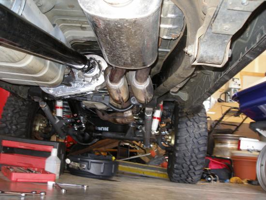

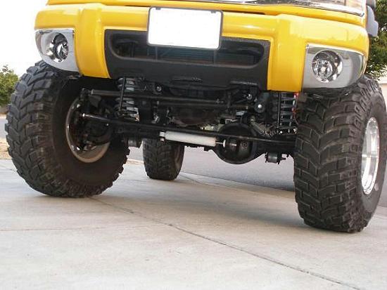

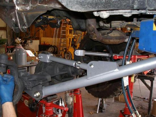

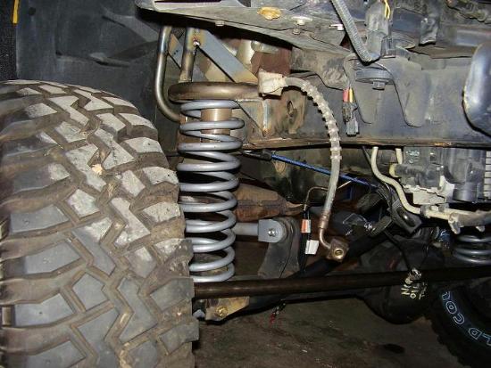

A Jeep Dana 30 straight axle from a 1997 Cherokee was swapped in using a Rubicon Express long arm kit. David was able to order only the parts he needed. The rear 8.8-inch axle was retained. It uses a leaf over axle conversion with stock F250 blocks for added lift.
The axles were treated to ARB air lockers and 4.88 gears.
Currie Anti Rock sway bars are also used.
The tires are 35-inch Mickey Thompson Baja Claws on Allied Type 887 Rock Crusher rims.

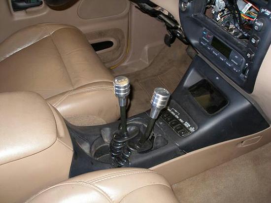

An Atlas II transfer case is used to improve its off-road ability. 1-inch was cut out of the output shaft on the 4R70 transmission rather than using a 1-inch adapter plate.

(Welding Up The Back Doors)
(Atlas II Twin Stick Cable Shifters)
