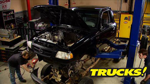

Lifting

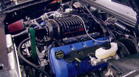

off the body to remove the drivetrin ![](images/trucks_rolling_thunder_engine.JPG)
Supercharged
Ford 4.6L V8 ![](images/Powerblock_Trucks_kevin-ryan.jpg)

Ford Racing 4.6L DOHC Aluminator crate engine
Whipple 2.3L Supercharger
’03 Cobra PCM, 2 custom dyno tunes, stand alone engine harness
