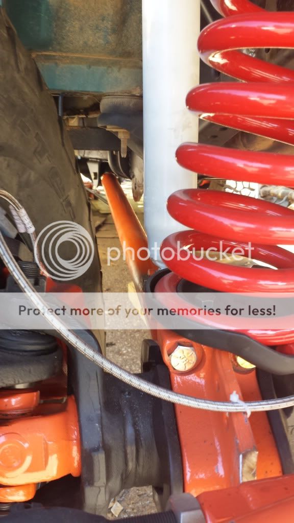

Figured I should build some radius arms, since I was tired of rubbing the tires on the stock ones, not to mention I figured it would help with flex
finished product

The design on the radius arms is rather unsafe. You should have had the tubing bent to keep the integrity intact. There's just too many stresser areas.
Other than that, nice little rig you've got there. I absolutely love the way you routed the front brake hoses.

Thanks, although I have to admit the brake line idea wasn't all mine.
I completely agree that it would have been stronger to bend the lower tube rather than miter it, however the lower tube is there more to tie in the end of the arm and for looks, and wasn't needed structurally.

What did you set the caster at on your extended radius arms?
IIRC, I set it as close as I could to 5*. When I took it to get it aligned, the alignment collars ended up being pretty close to centered, with a ways of adjustment +/-.
