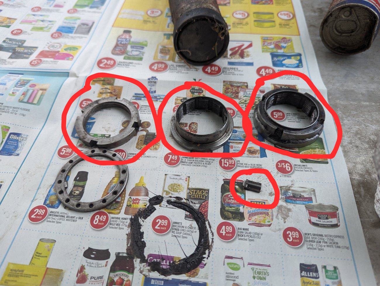

On this same topic, anyone tried the ratcheting inner nuts from an F-150?
Part number: E7TZ-1A134-A
lil_Blue_Ford
Cut & Weld
TRS Forum Moderator
Supporting Member
V8 Engine Swap
TRS 25th Anniversary
Aug 6, 2007
9,910
Reaction score
8,595
Location
Butler, PA, USSA
00
Make / Model
Ford
Engine Type
V8
Engine Size
5.0l
Total Drop
4”
I have those ratcheting ones on my F-150 and love them. Definitely makes it easier to service. Never thought to try them on my Choptop with the D-35....

^^^ I have to be a smartass....use an allen key?

while it's inside the hub? note which way the allen head is pointed.
From smartass to dumbass in one sentence....thanks....ok, two sentences:icon_twisted:

how do you tighten the allen screws?
With the locking hub removed, you'd be able to tighten that allen head easily.
On the Dana 35, the hubs just slide over the top of the spindle and spindle nuts, and are held on by the wheel/lugnuts

Now I feel even dumber, if that's possible. It must be my pain meds...yeah.

As long as the OD fits inside the hub, I guess almost any of these ideas would work.
It has been a long time since I worked on my F150 (sold it long ago [emoji29]). I don't remember how those ratcheting nuts worked. Must have been simple because I don't think I had a torque wrench back then.
