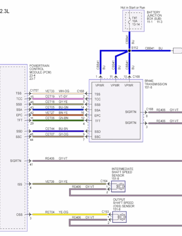

I wonder if there is a pid for the solenoid A resistance? If so you could set that to read in Forscan and go around wiggling wires until it shows open circuit.

If there is my bluedriver and CRP129 cant access it. I did test the resistance (was within spec) and I manually energized the solenoid with 12 volt to verify it does/can open a close (it does).

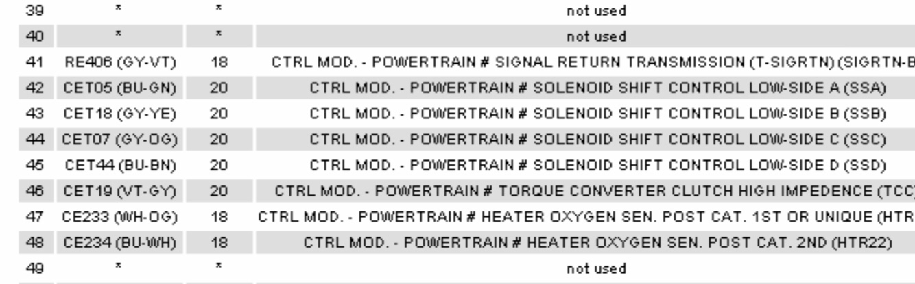

I ordered a wiring diagram for the truck which hasn't arrived yet so I can find and test the pin from the ECU down to the transmission connection. If I can get my meter on the proper pins I could do the wiggle test with that.

Just tested the wire for SSA at the trans connection to pcm connection. No issues with the wire, wiggled the crap out of it through the entire length and not a blip on the screen. No visible damage anywhere either. The pin at the pcm is also clean with no visible corrosion or damage. I have no idea what else I can possibly test or check. Ive now verified the internal and external wiring to the solenoid is good, solenoid itself is good, valve body and gaskets have no pressure leaks, fluid is clean and filled properly and as always shifts fine.

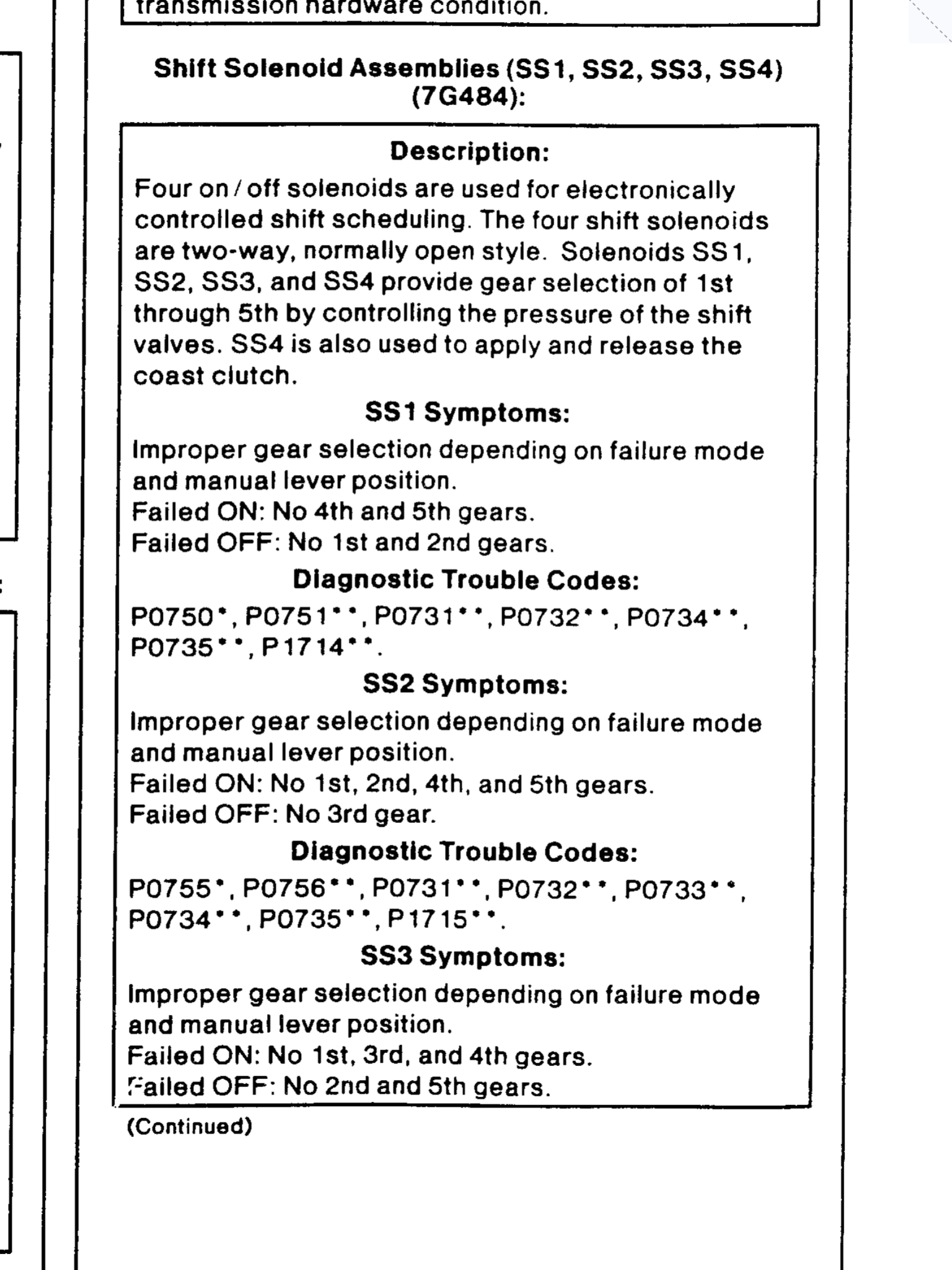

For solenoid A(1) we have these:
P0750 Shift Solenoid A Malfunction
P0751 Shift Solenoid A Performance or Stuck Off
P0752 Shift Solenoid A Stuck On
P0753 Shift Solenoid A Electrical
P0754 Shift Solenoid A Intermittent
Computer didn't use 753, electrical fault
It didn't use 751 or 752, solenoid stuck on or off
It didn't use 754, works GOOD but only once in awhile, intermittent
It did use 750, malfunction, but not electrical malfunction
Narrows it down but not specific

According to the link shift solenoid A is active in first - third and reverse so active alot. Failure in this solenoid seems like it would cause issues all over. I hate problems like this...

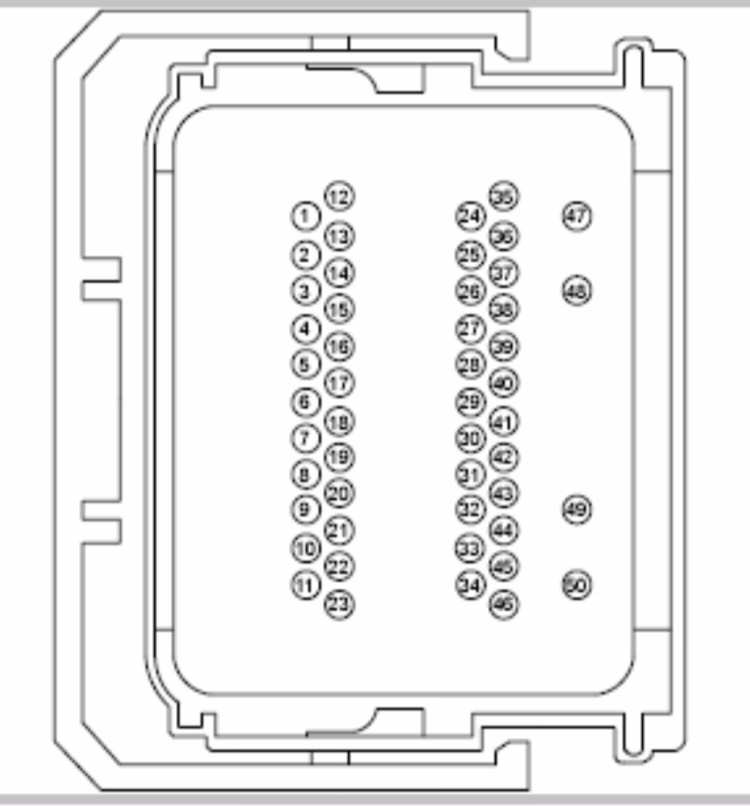

Ok, both my scanners just aren't good enough to read the PIDs for the range sensor voltage. Any way to do it by just backprobing with a multi meter or test it off the vehicle? I dont know if you remeber my other post about the shifter being incredibly hard to move, Ive determined that is the result of the range sensor being super hard to rotate, and the plastic collar is cracked so at this point I'm ready to just replace the damn thing anyway. However id like to see if it is or isn't related to the p0750 issue and not just wait months seeing if the code comes back lol.

Can’t test it off of vehicle. Here is more info that my help with diagnosis.
