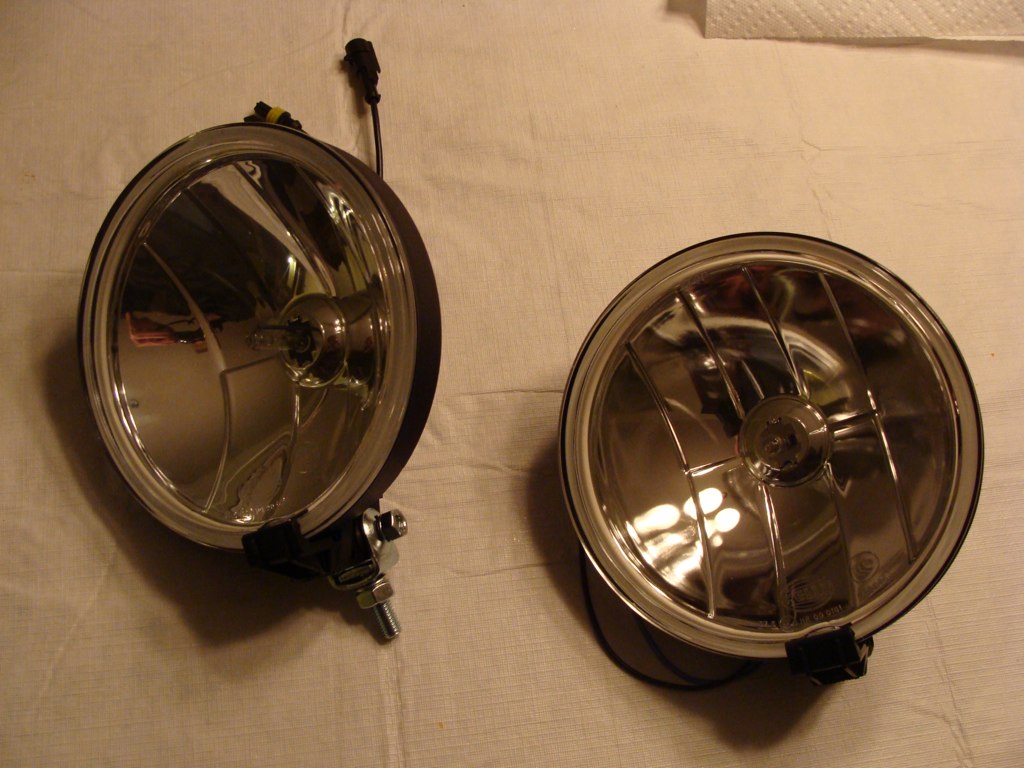

Here's a picture of two 700ff's, one that's been converted, the other which hasn't.
Here's a closeup of the light before the conversion:
Here's a closeup after the conversion:

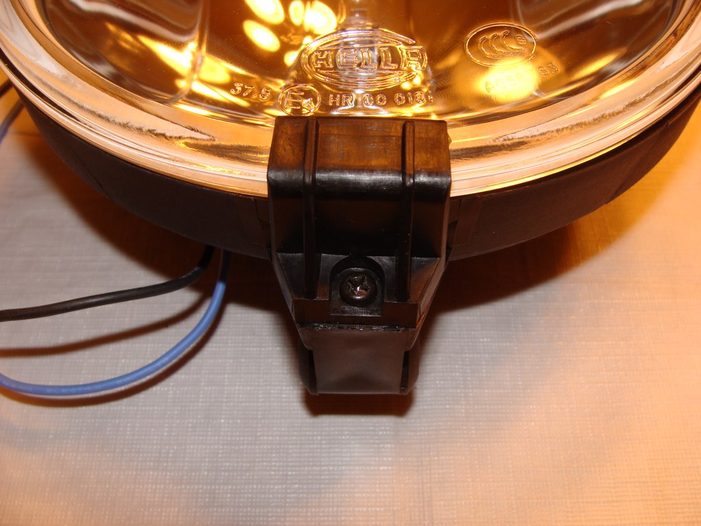

The first step is to disassemble the light. This should be fairly straightforward, but I'll walk you through it anyway.
1) There should be a small plastic piece held in place by a screw at the bottom of the light. Use your Phillips screwdriver to remove that screw, and then flip the plastic piece down (somtimes they "hinge" other times the plastic bit completely comes off. This one came completely off, don't worry about what yours does, it doesn't matter.)
Here's the plastic piece and screw removed.

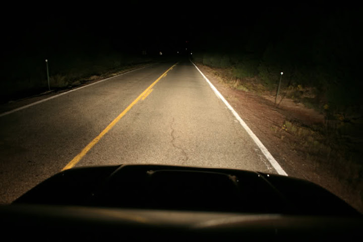

Just wanted to make a quick post, regarding these lights and their effectiveness.
I found on a Tachoma forum, a guy who did this exact conversion, and posted results. So I'm just posting the photo's, to give an idea of what the beams look like in use!
Low Beam:
High Beam:
High Beam with two HID Hella 700ff's up front: :D
Don't know about you, but thats rather shockingly bright! :O
