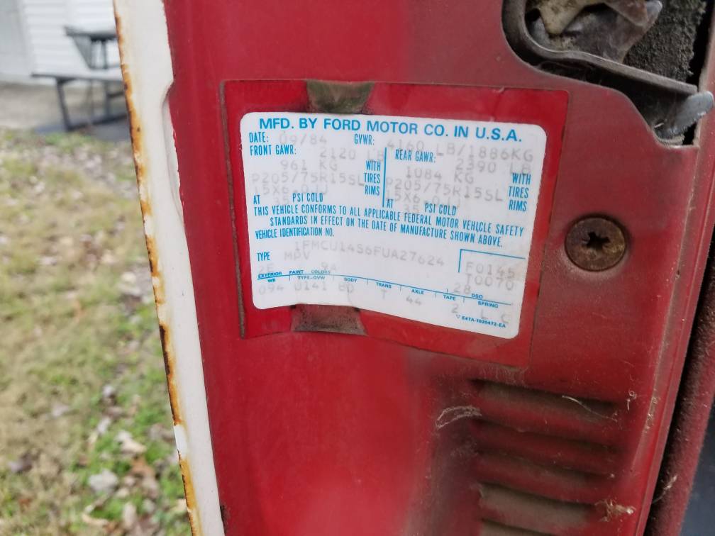

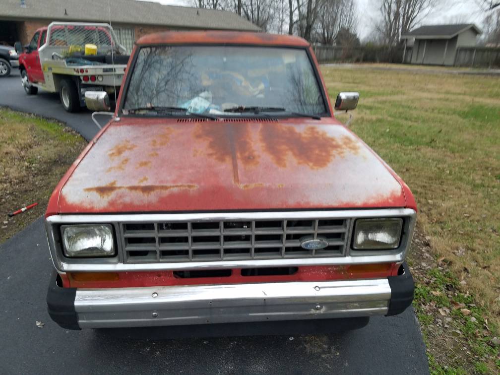

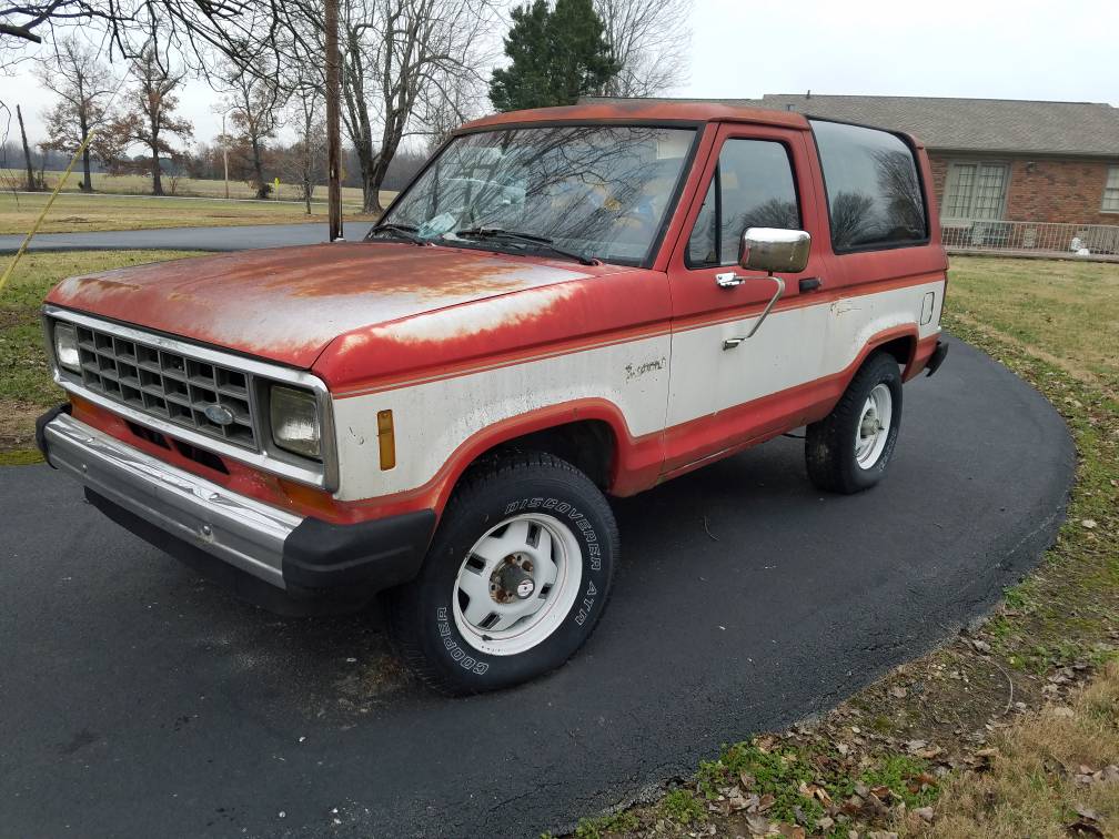

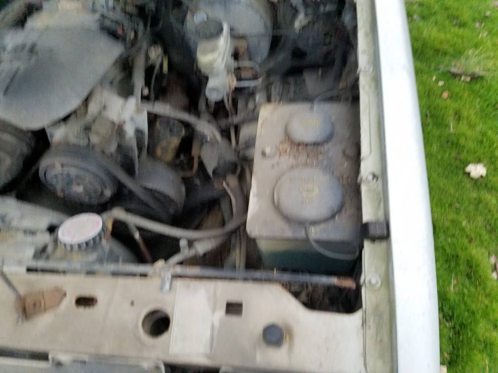

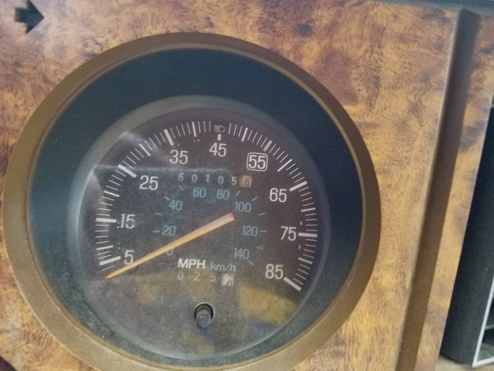

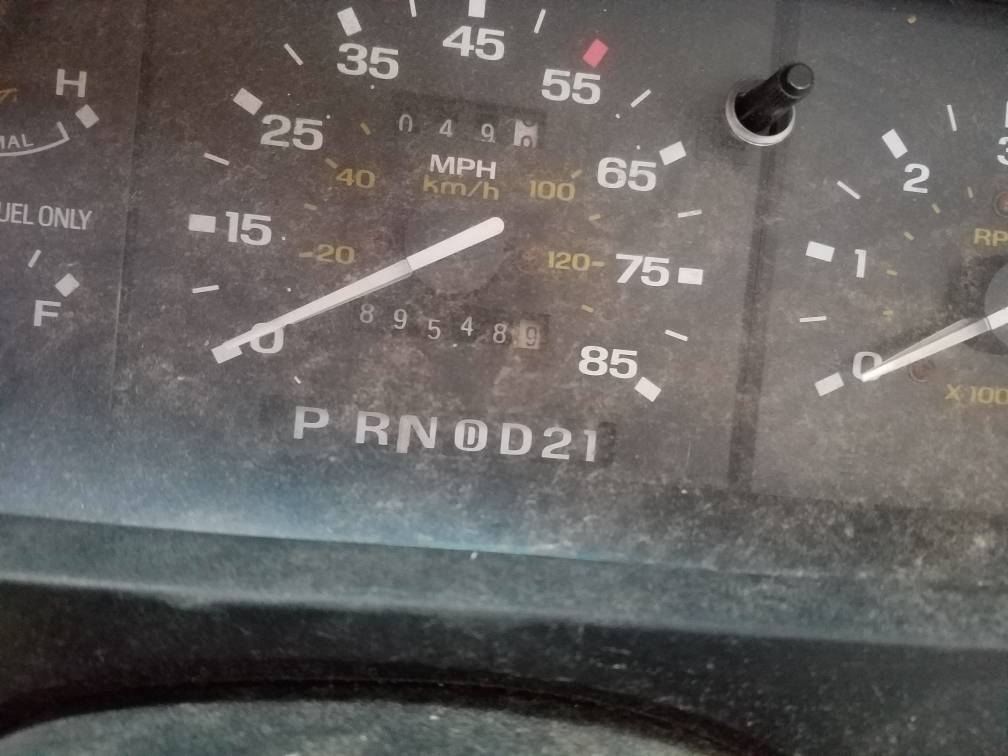

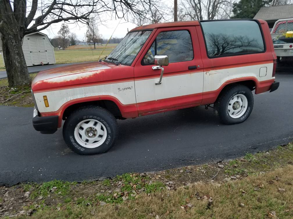

Finally made it to my grandad's to get some pictures.
Looks like only 60k original miles.
Something has been living in engine bay, but I don't see any oil leaks.
Needs a paint job. Interior needs to be redone.
I would probably replace all the door seals.
It's full of junk so I didn't get any pics of the interior.
I think I'll have to tow it home and go through it a little at a time to get it going again.

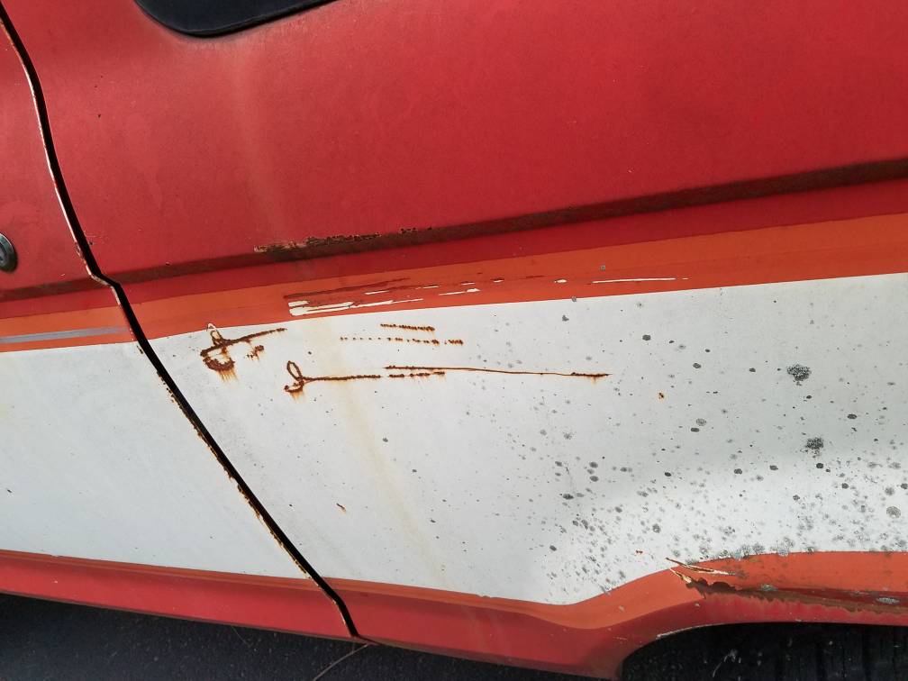

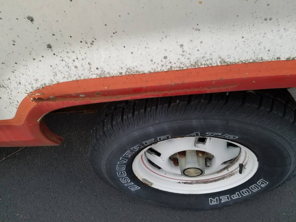

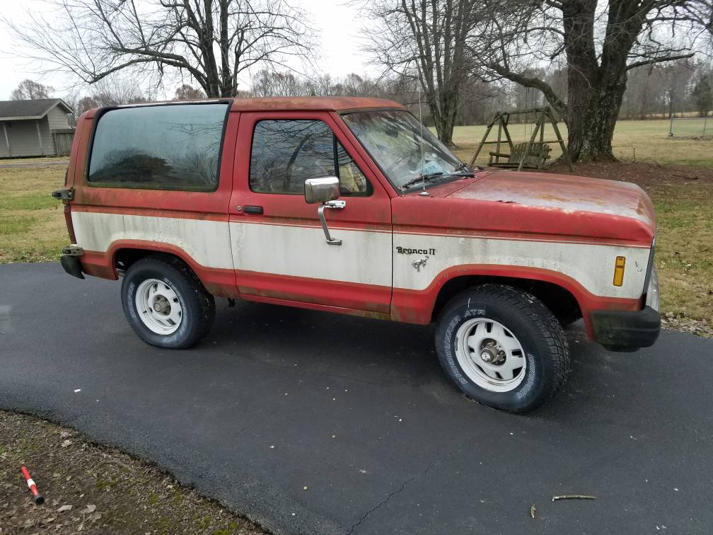

There are a few panels with dents, but doesn't appear to be any rot, just surface rust.

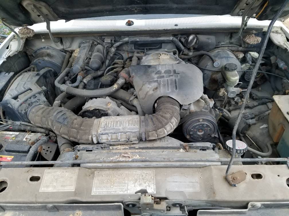

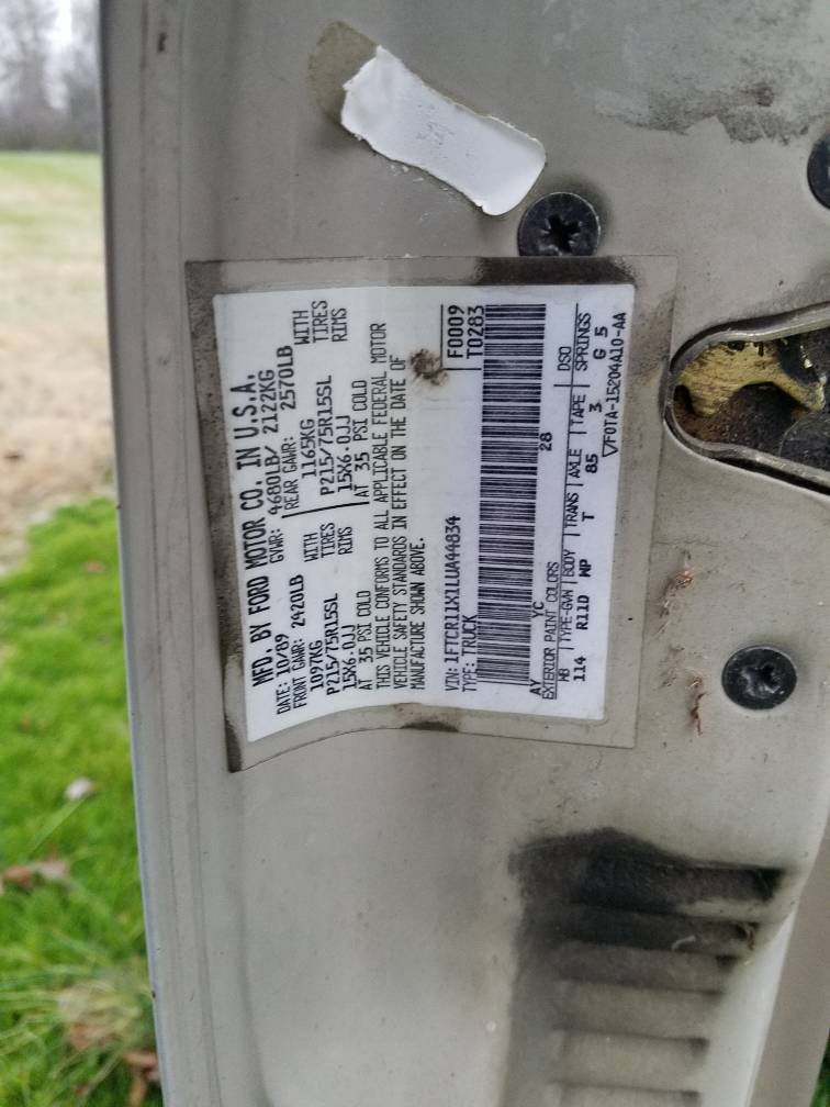

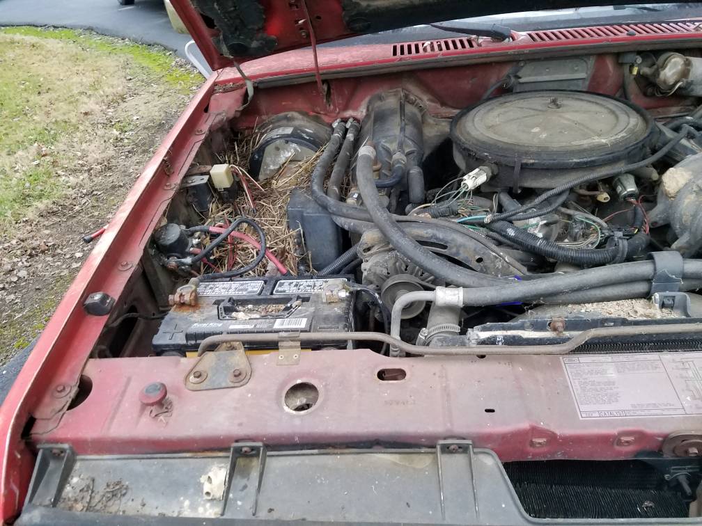

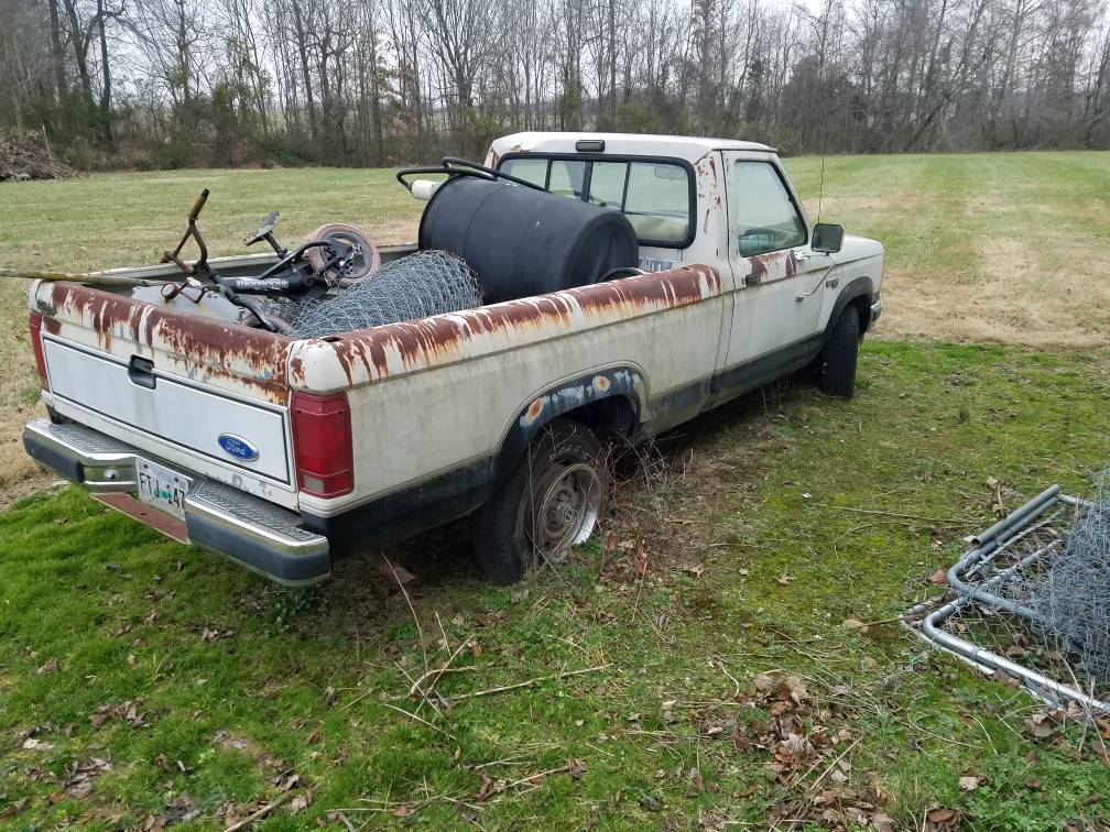

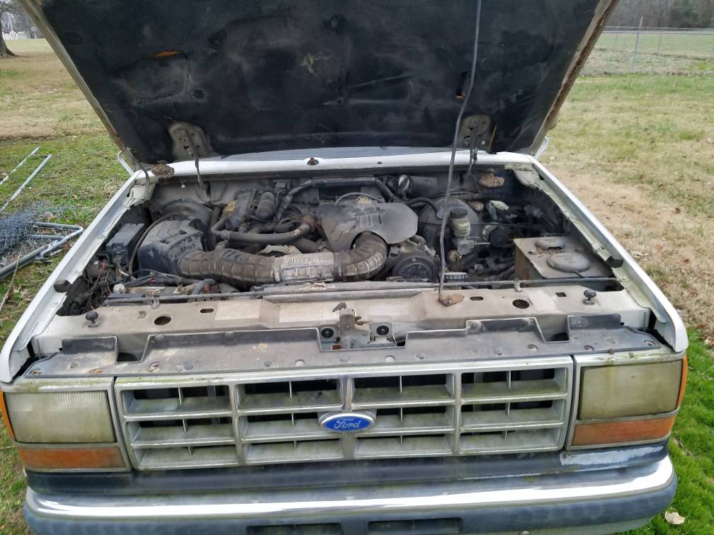

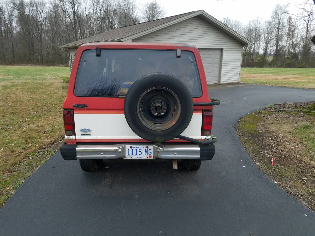

Also got some pictures of the potential donor for a 4.0 and other parts.
Sent from my SAMSUNG-SM-G891A using Tapatalk
32,213
17,528
Do either run?
I am mildly impressed to see the jack handle correctly stowed on both rigs :icon_thumby:
ford4wd08
Nov 12, 2018
1,249
510
Alcoa, TN
2.8 V6
Do either run?
The old saying it did when it was parked comes to mind.
I suspect the bronco will be fairly easy to get running as long as somethimg didnt go nuts on the wiring.
The ranger ran really well at one time, but it has had less use than the bronco in recent years.
I can assure they were both bought new and operated by people in at least their 50's. No abuse i can think of other than sitting.
