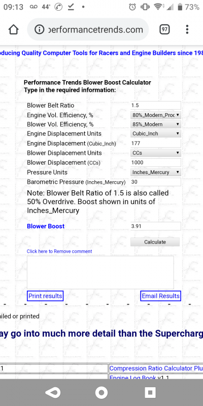

That was my exact idea, and why the Toyota SC12 is in the running. Cool little supercharger with an electric clutch on it. Looks like it would bolt right in to the slot where my a/c compressor was.
I would have to overdrive it to a pretty ridiculous degree to get it to push enough wind, but, with a switch rigged into the tach, I could have it auto engage and disengage to avoid over-revving it and shooting supercharger shrapnel into my intake. Or have the clutch stick and do exactly that.

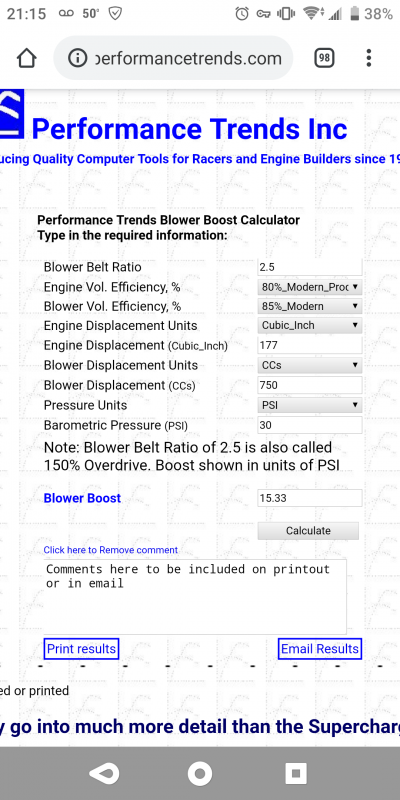

From the math, a 1000 cc supercharger looks like what I would want to find. But these little AMR500 blowers can be had refurbished for the super cheap on fleaBay. So, figured I'd post on here to have some people shoot all kinds of holes in my idea first.
Not looking for a dragstrip mini truck here. Just want something novel that gets onto a highway a little easier. And maybe to listen to some boost whine. [emoji23] So, I'm hoping you're response is possible; it was my rationale.

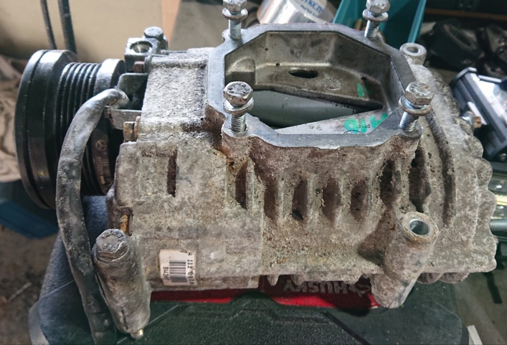

Well, back with more bad ideas today.
Mentioned this in my build thread. Eaton M45 (R52 or R53?), intercooler, blow off/bypass, water pump (lol), etc. Out the door for $60.
Worst case, eBay. Best case, use it. Anyone know of any builds out there with this blower being adapted to another engine?
