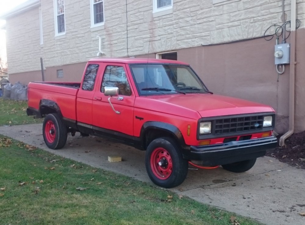

More photos and story to follow, but the as-purchased photo:
