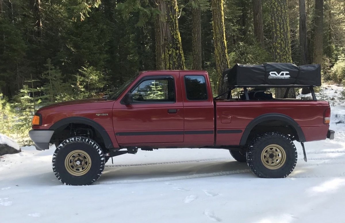

Hey guys!
i just bought a 1997 extra cab ranger 4.0 liter 4x4, which probably needs a new transmission, it has no reverse and no engine breaking in manual 1st. So when i get it ill investigate more to see if its the servo or seals or band, but i cant check until i get it down here from seattle, and yes i plan to drive it down!!. I had my dad good look at it and and its pretty close to what i want to build up
It is a:
*1997 ranger 4.0L 4x4
*Automatic /wish it was a manual but oh well
*TTB front end obviously
*only 121K miles
*got it for 2000 $
My plan is to throw on a Skyjacker 4" lift class 2 (top of the line one for them) with a steering stabilizer, on the skyjacker kit go with either their top of the line M95 shocks or buy it with out the shocks and go with bilsteins 5100, really i would like some foxes, but money wont allow. then replace the 31's with 33's (Probably need to re-gear since im only at 3.73) then replace all the body mounts and if i think it needs it ill add a 1.5 inch body lift while in doing the mounts.
The reason i am not going with a 6" suspension lift if because of the notorious steering issues with going that high, i want reliability and am willing to make up the extra room with a body lift since i am planning on replacing the body mounts any how.
possibly ass a snorkel for dust mitigation and water crossing of course
Then get a bumper or build one and winch 8k-10k, and since i have a welder i am planning on building a bed rack to put my rooftop tent on for camping, and then beat the hell out of it!
other things i plan to do are
* Full size spare
* Possibly a swing out rear bumper
* Manual locking hubs for reliability
* Swap the 2 piece drive shaft for a single
* Build a platform box in the back of the cab for my dogs to hang out on and with storage underneath
* I might move my dual battery set up with 800 watt inverter over from my avalanche since this will be my main wheeling/camping rig
Im welcome to hear any input or anything else people would recommend doing to make this a killer off-road rig (besides SAS, im keeping TTB), im hoping to keep it under 8K... but lets all be honest we know how that goes.
