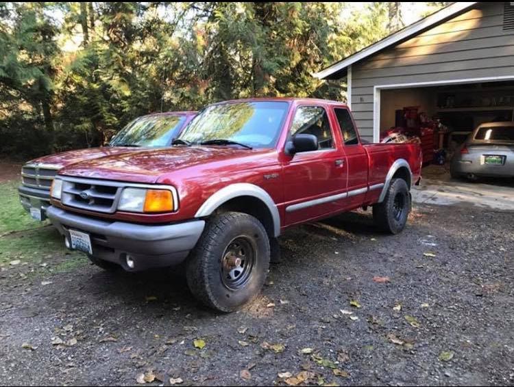

Hey guys!
i just bought a 1997 extra cab ranger 4.0 liter 4x4, which probably needs a new transmission, it has no reverse and no engine breaking in manual 1st. So when i get it ill investigate more to see if its the servo or seals or band, but i cant check until i get it down here from seattle, and yes i plan to drive it down!!. I had my dad good look at it and and its pretty close to what i want to build up
It is a:
*1997 ranger 4.0L 4x4
*Automatic /wish it was a manual but oh well
*TTB front end obviously
*only 121K miles
*got it for 2000 $
My plan is to throw on a Skyjacker 4" lift class 2 (top of the line one for them) with a steering stabilizer, on the skyjacker kit go with either their top of the line M95 shocks or buy it with out the shocks and go with bilsteins 5100, really i would like some foxes, but money wont allow. then replace the 31's with 33's (Probably need to re-gear since im only at 3.73) then replace all the body mounts and if i think it needs it ill add a 1.5 inch body lift while in doing the mounts.
The reason i am not going with a 6" suspension lift if because of the notorious steering issues with going that high, i want reliability and am willing to make up the extra room with a body lift since i am planning on replacing the body mounts any how.
possibly ass a snorkel for dust mitigation and water crossing of course
Then get a bumper or build one and winch 8k-10k, and since i have a welder i am planning on building a bed rack to put my rooftop tent on for camping, and then beat the hell out of it!

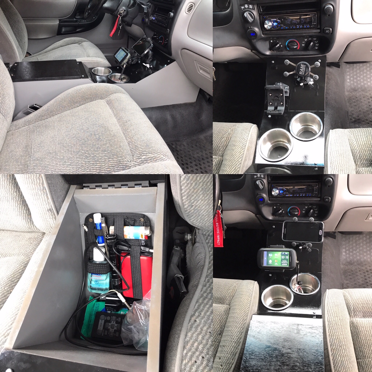

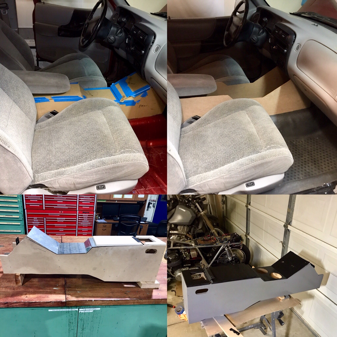

After about 2 weeks of off and on working on the rangers new center console, it’s done!! I now have 2 powered RAM mounts one for phones and one for my garmin with the cords all stashed away inside, and a place to mount my maglite and radio when i get it, plus i think it just looks cooler than the old stock one. Also i ditches the old nasty carpet and put in a vinyl floor from a sport trac.
with that sport trac i took the driveshaft to replace my old 2 piece one with a worn out carrier bearing. i haven’t done anything with the transmission yet but after reading a bit i think the 1997 5r55e had an extra sensor so i may have to just get it fully rebuilt, anyone know anything about 1997’s being special?

Nice job on the console.
1996xlt
Jul 22, 2009
257
23
NC
Always wanted to get the vinyl floor out of a sport trac and put it in my truck, looks good! Any significant trimming to get it to fit?
