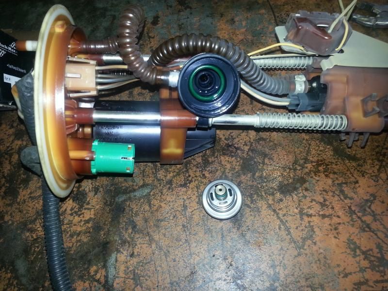

Fuel System:
The fuel pressures and fuel pressure regulator systems are quite different between the early Explorer V8's and the later Rangers.
The Explorers (through '98) use a nominal 2.5 – 3 bar system with the FPR at the fuel rail and a return all the way back to the tank.
The later Rangers use a nominal 4 bar system with the FPR in the fuel tank and a pressure bleed off circuit leaving the fuel filter going back to the FPR.
Running the 3 bar system at 4 bars of pressure is asking more than the PCM can accommodate, perhaps replacing the 19 lbs/hr injectors with smaller ones, say 14 lbs might (at a cost) and using a later non-return fuel rail could keep things happy.
Another option would be to find a suitable FPR for the in-tank system. Dropping the pressure there would allow an early Expo V8 to run with the later non-return fuel rail correctly.
But, since I did not want to experiment with smaller injectors and did not have access to the Fuel Pressure Regulators “R” Us catalog, I decided retain the Explorer's fuel rail/FPR and adapt the Rangers system to accommodate.
Dropped the tank and removed the original FPR. Did swap in a new fuel pump while there.
Used a length of 3/8" generic fuel line repair to get a proper line connector and silver soldered it to the end of the front half of the Expo fuel return line. I've read of guys using compression unions and sawing off the 3/8" nipple off the back of the Ranger fuel filter.
Since the Ranger's fuel lines are different sizes at the inlet to the Explorer's fuel filter, I used push on fuel line unions to swap the 5/16" and 3/8" ends on the pair of 5/16" lines.
Once done, the Ranger's fuel supply plugs into the Explorer fuel filter inlet, the Expo fuel return line plugs into the Ranger's pressure bleed line and the Expo fuel filter pops into the Ranger's bracket like it was made for it.
Lastly, I found that both the original and a new FPR ran at the bottom of the pressure window for the system, added an adjustable FPR set to the upper end of the pressure window. Fuel trims run about -7% or so at high way cruising, nothing the PCM can't deal with and should improve fuel atomization.

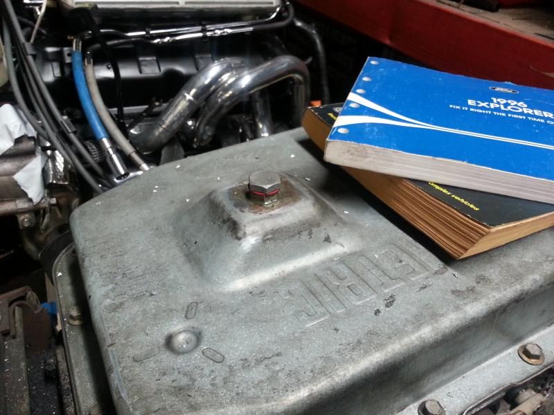

Transmission:
While the 4R70W transmission is out, take the time to change the filter and inspect the 1st/2nd accumulator springs. They're notorious for breaking causing harsh up-shifts into 2nd. I've no idea what the broken spring color is, and did not find any info on the yellow upper spring. I swapped in a matched pair of white/pink springs.
Added a drain plug in the trans pan while there:

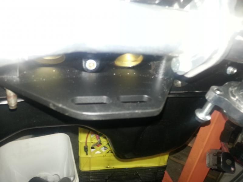

1st problem with the cats was clearance at the transmission cross member. Had to lift the back of the trans 3/4”, trim one of the welded on cat supports and a bit of re-shaping the of the front corner of the cross member. Another issue was clearance for the left down pipe at the oil pan – mandated the use the Expo rear sump oil pan. (or massive re-shaping of a different sump).
With the back of the transmission raised that high, I had the oil pan carrying the weight of the engine at the rack and pinion unit.
Using the Strada Shop mounting plates, I had to lift the mounts 3/8” and use an steel Explorer oil pan to get the clearance I needed. End result is an engine that sits level in the engine bay. Did have to notch one plate to clear a plug on the side of the block and trim the plates quite a bit for aesthetics and clearance for the Torque Monster headers.
At least in my case, the drop in the right side Strada Shop engine plate could have been eliminated and a similar lift added in to the left side. Would make home made flat plates a very workable solution using shims for the left side lift.
On the transmission bell housing, I trimmed off a pair of tabs to add clearance and to clear the Expo cat, trimmed a bit off the right side lower control arm mount bracket. All non-structural stuff.
The Expo oil pan was STUPID tight during the install with the transmission mounted to the engine. I decided to move the leading edge of the sump to the drain plug, used a Ford Racing Parts rear sump oil pickup but could have modified the Expo to fit. Made the fit and install a snap but I did have real problems getting the pan liquid tight. The steel was so stressed from the stamping that it was cracking inches away from where I was brazing the cuts and splices. Once I had it tight, I decided not to do any cleanup of the brazes. Super thin steel that was very very heat sensitive kept the brazes a bit on the ugly side. I'm sure a skilled TIG welder would not have had the heat issue I did, but a skilled TIG welder I'm not!
A different catalytic converter/exhaust solution would have make the generic Ford Racing Parts rear sump oil pan a very viable option and not having to raise the back of the transmission would have only helped at the rack and pinion.

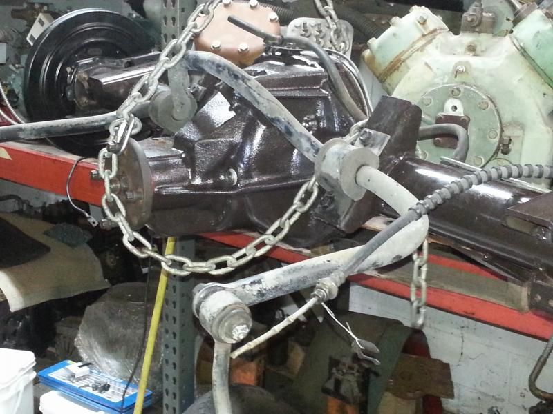

Diff/rear axle. Used the Expo 8.8 LSD/Disk brake axle. Cut off the Expo sway bar and torque rod brackets. Used 3” tube spring perches opposite the original Expo perches as well as a 2nd pair for the Bronco II 1” sway bar brackets. Added in a pair of 3” tube shock mounts for the Ranger shocks.
Only problem so far is the Ranger e-brake cable bracket is not a great solution for the Expo cables. Gotta work on that.

Fuel System:
Transmission:
