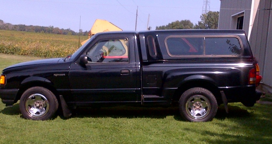

The 96 Splash I'm using for the swap. The topper on the back is no longer there. Not something I want on the truck. Aside from the V8 it looks virtually identical to the Explorer from the firewall forward and both are automatics with AC, cruise etc. I bought it specifically to do a V8 swap.

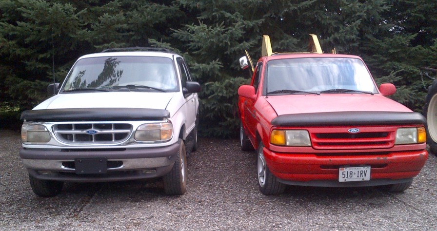

My 93 Splash and the V8 96 Explorer donor I just bought. The 93 needs an etest to get back on the road again. It has 240,000 miles on it . The original owner had a 140 mile round trip commute to work. The engine is pretty close to being pooched. It needs a bit of bodywork (passenger side cab corner) but the frame and everything else is really good. My son and daughter occasionally borrow my pickup so I might fix up the 93 and let them share it as needed.

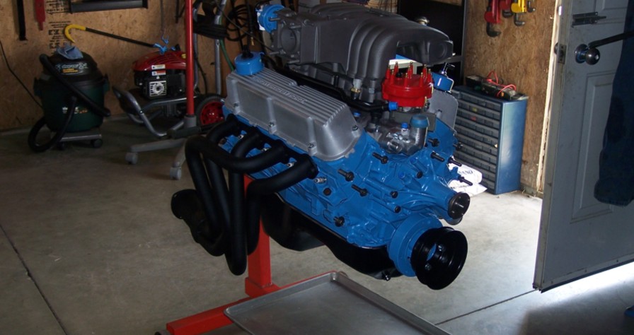

5.0 HO engine stashed in my shop. It's a one owner (me). Gonna use the short block + fresh GT40 heads from it with everything else on the Explorer engine now. The engine is from a 1990 Mustang I bought new. I also have the 5 speed transmission, shifter, bell housing, computer and all of the engine accessories, emissions stuff etc.

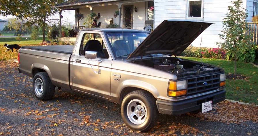

The 90 5.0 Ranger I had before the 347. Sold it to a batshit crazy nickel miner from the Thunder Bay area. He flew to a small city near me and I picked him up on a Sunday morning at a sleazy hotel with a strip joint on the first floor. He had a drug related criminal record so he couldn't cross the border to take a shortcut through Michigan and had to take a 1000 mile trip through the wilds of Northern Ontario to get home. He did a smoky burnout as he left my place, which was probably a bad idea given the rigours of the journey ahead of him. He had no tools, no spare, no anything. Not even an extra can of gas. I actually offered him a spare tire but he said nope don't bother. Never heard from him again.
This particular Ranger has an unusual owner history. The V6 engine eventually got fried after a head gasket blew and my wife didn't notice the huge white steaming contrail billowing along behind her. My brother wanted to do a V8 swap so I sold it to him. He did the swap and I eventually bought it from him. I sold it back to him a while later and he sold it to some other guy. I bought it back from that guy, then my brother bought it back from me, and I bought it from him again and sold it to the miner. So I owned it 4 times and my brother 3 times.
