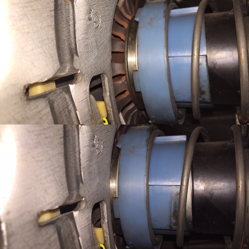

Just a little followup...
I was prepared to pull the MC to do a full bleed when I thought I'd take a peek inside the bell housing though the inspection cover. Clutch to the floor showed good movement of the pressure plate springs, so I repeated the clutch drag test in my first post.
To my total surprise, there was virtually no clutch drag. It took less than 5 lbs on the wheel to rotate it, and it did so with 1.5" left to push the pedal. I tried both wheels and related the test a number of times. Same thing each time.
I know I'm not crazy, because I have tons of photos showing that it took nearly 25 lbs to rotate the wheel with the pedal to the floor. Something clearly changes from time to time with that clutch, and I'm not yet clear what that is.
Regardless, I was able to more confidently isolate the clutch problems from the transmission problems, and I agree with the previous mechanics now--that transmission isn't well. I get the block-out condition in first gear every time and lots of small grinds and kicks when shifts aren't carefully timed.
The truck runs pretty well and is basically a 1/2 ton truck in a small truck's body, so I think putting out ~$1700 for a new transmission will be worth it. I'm drawing up plans for a rack and still have hopes of putting a TrueTrac in the rear someday. Hope I'll get another 160k mi from it.
