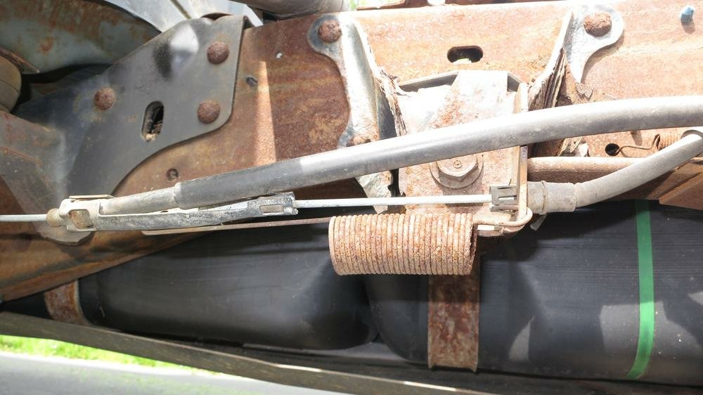

I think the F150 cable connector would work. I've not tried it yet. looks like this.
This is for jeeps. I like it. and wonder

Denisefwd93, the photos you posted are for connecting the intermediate cable to the 2 rear brake cables. The piece I am looking for is the one that connects the Front Parking brake cable to the intermediate cable. Thank you for taking the time to post those photos.

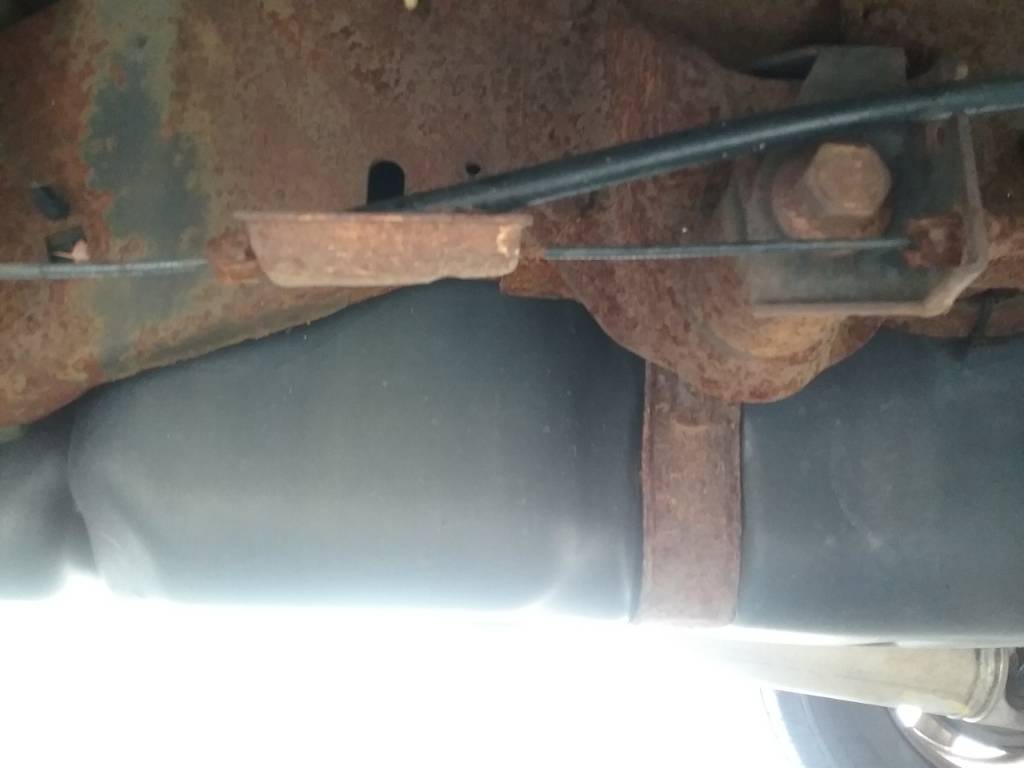

Rockauto sells the cables with the snap lock things. I don't know about lifts but I thought sometimes the OE cables are to short for lifted trucks.

Modelageek thank you for the photos, that really helps show how they connect. I have a couple of those on the rear brake cables that attach to the intermediate cable but I wasn't sure if they were the same thing that connects the front cable to the intermediate cable. Yeah I'm not sure if it broke or was just too short after the cheap lift. That is one of the reasons I am trying to return it to stock height. Well and the fact that I'm old and fat so have a hard time getting in it with it lifted.

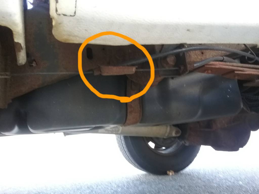

Okay I've figured out the intermediate cable to the front cable, but how does the intermediate cable connect to the left and right brake cables. DeniseFWD posted that the intermediate cable pulls the left side cable and the left side cable pulls the right cable. I am just not understanding how this all goes together. Does anyone have a photo of those connections?

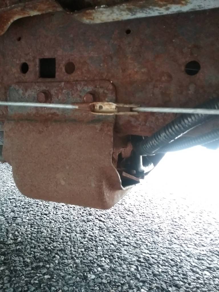

This is from my 04 but I remember my 99 had the exact same setup. Go to a junkyard with some wire cutters.

I just noticed my cable sitting on the leaf spring, so I moved the protective cover back over it, taped it in place and pulled it up with a ziptie
