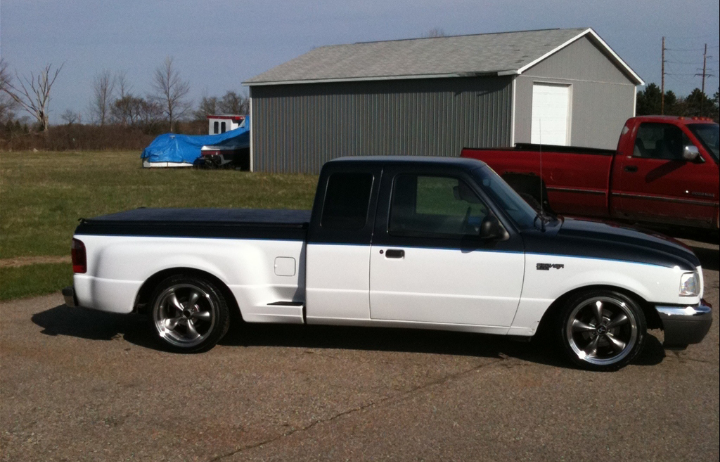

Hey guys, newbie here. I've got a a dropped 02 that I'm pretty decided that it's time to turn it into a prerunner. I've been riding bikes and q uads since I was a teenager, now that I'm in my 30s I would like to play in the dunes and be in something rather then be on it. Now mind you I'm not sure what I'm doing here but let's just say that I don't have a problem with fabrication.
The Ranger.

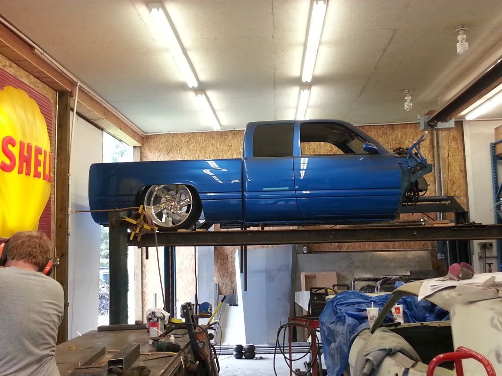

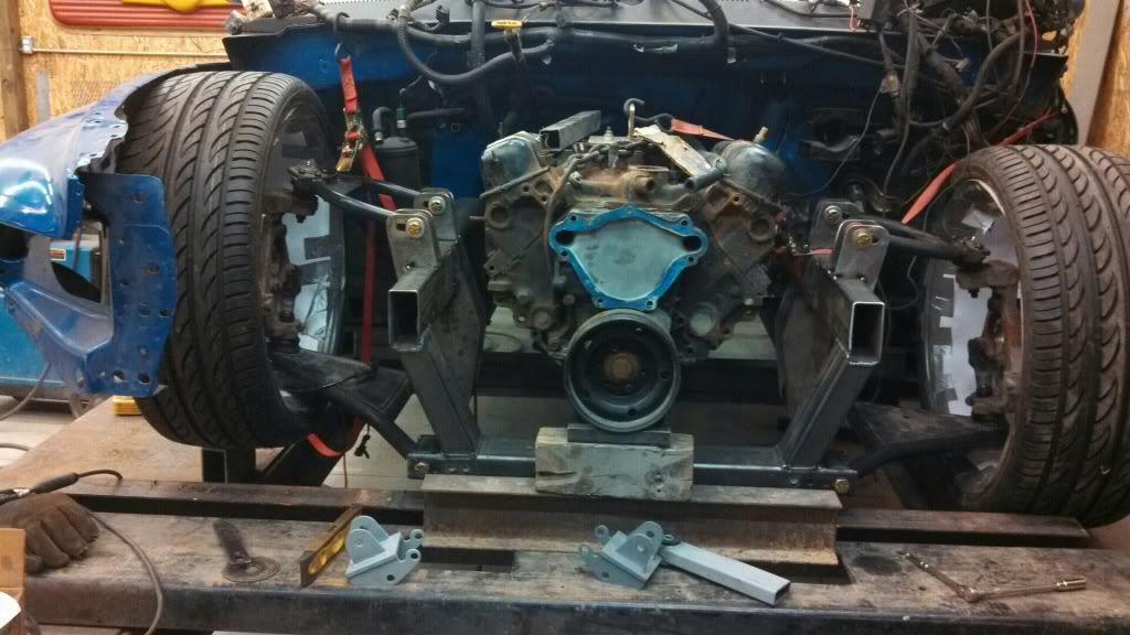

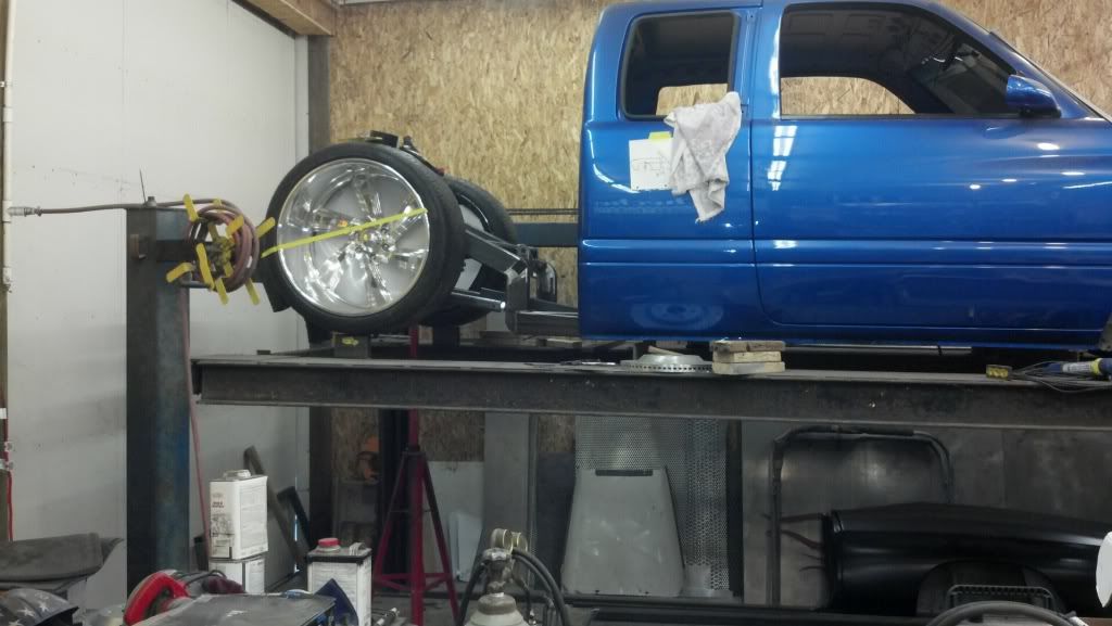

Current build, my Ram.

I'd like something that I could still DD but with that being said I have a warped sense when it comes to what is a DD. Drove a bagged out ACR neon with a full cage for 3 winters while my f350 sat in the garage, and currently been using the Ranger as my DD (winter add all) with only 3ins of ground clearance lol.
But what I am picturing is a full bed cage, trailing arms and coil overs out back, front engine cage and some long travel arms. I'm not apposed to running rear leafs if the price is significantly less then a trailing arm setup yet still contains good handling. And to be 100% honest, this might only see the dunes several times a year. I just want something that I can have fun with and still drive.. Though about building a 2 seat mini buggy but don't want to store it.
Figured since I'm always wanted a prerunner and have the Ranger as the perfect platform to just go with it.
