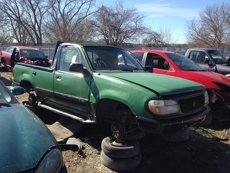

Honestly, id buy an exploder and cut the back roof section off....make a nice something to put behind the seats for a bulkhead, and keep on truckin

'Tis been done, it wasn't overly pretty but I did witness such a creation at u-pull-it a few years ago. They went wild and knocked the back seats out too.
I mean, that looks like a 3 yr old got ahold of dads sawzall after a night of soda and animal crackers.
I think if done right, it would look better then trying to graft a sport trac cab to a ranger.
