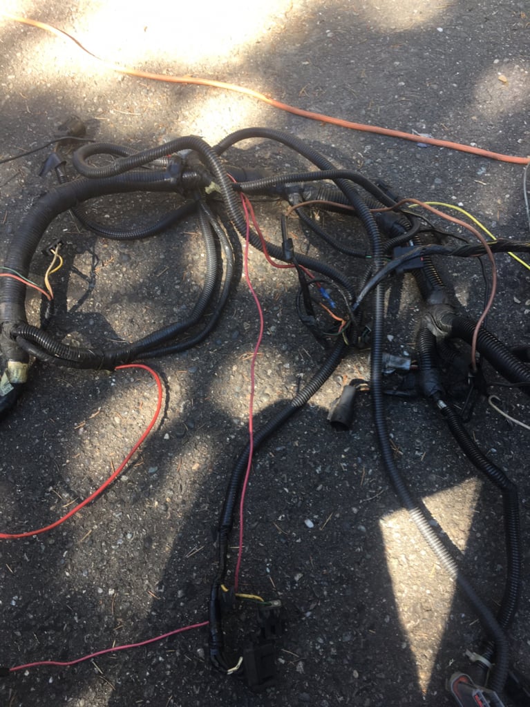

I need to figure out a wiring issue on the firewall. Looks like instead of putting connectors on the wires for the fuse box someone just cut a bigger hole :huh::dunno: So I have to fix that at some point.

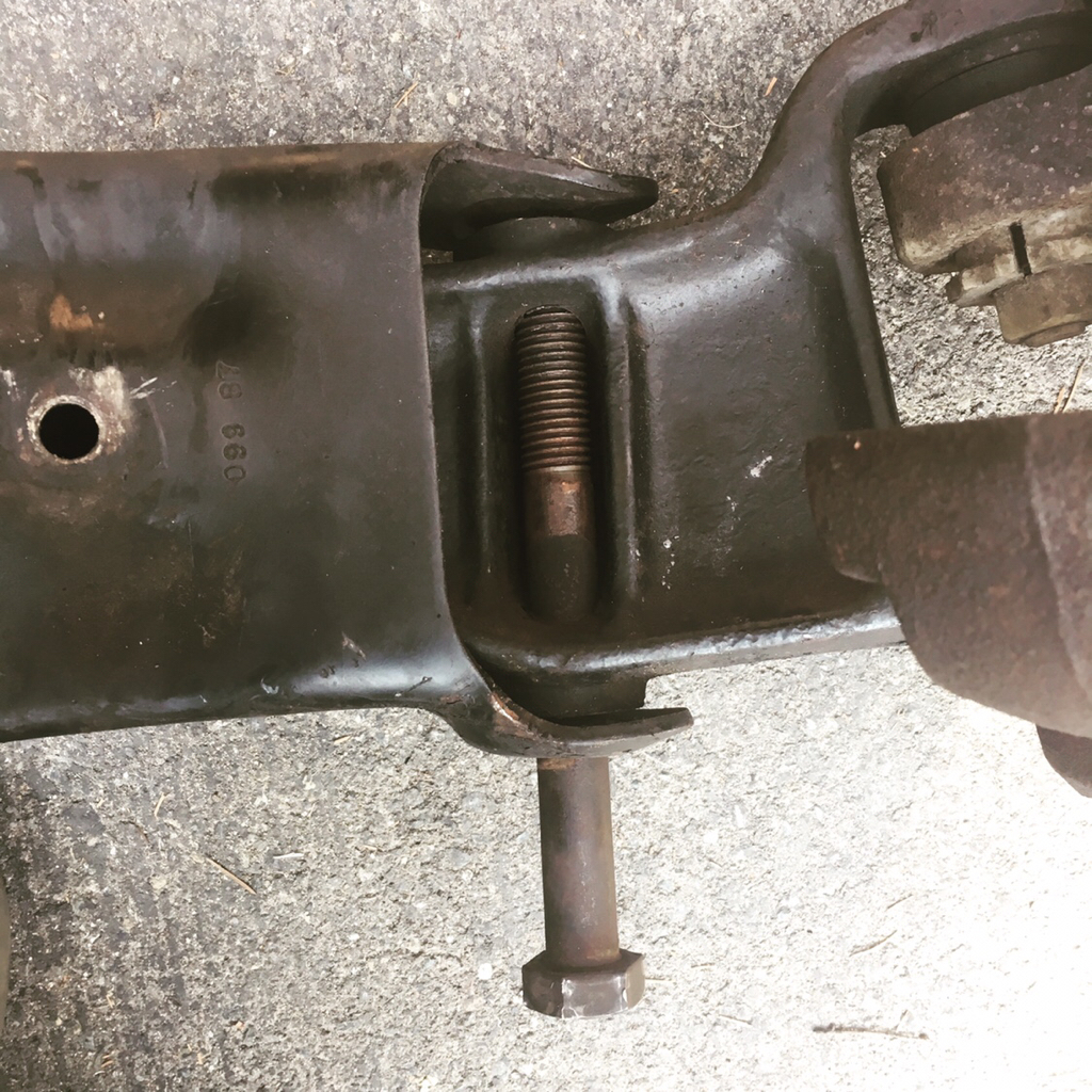

I'm at a road block trying to get my lowering beams in since I can't get the bolts undone from the radius arms. They are just stuck and not going anywhere. Eventually I'll be able to get them undone but for now my beams, knuckles and new ball joints are going to have to wait.

Oh yeah, my wiring is a rats nest. Not sure where a lot of it goes but I'm sure it'll be fun [emoji15]

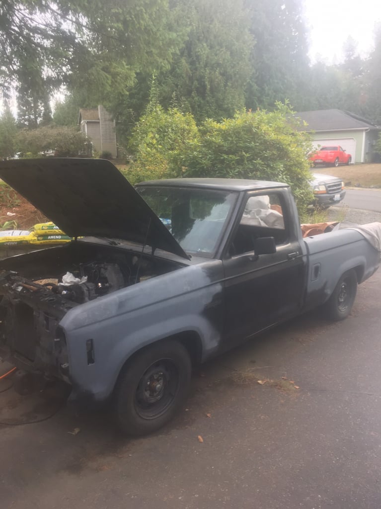

Some more work done yesterday. Mostly just sent smashing and filling.
Here are some pictures inside the cab. You can see my lovely patches. Those may get pulled out at some point but I was going for functionality. I just put some basic sheet metal in and used fiberglass filler to cover.
I'm not sure what to do with the transmission tunnel still. For whatever reason someone decided that it'd be grand to cut lines along it so those may either be getting patched or I'll replace parts of the tunnel itself.
Been thinking lately that I'm going to try and get a motor and transmission from an 88ish turbocoupe and transplant it in after doing a rebuild: or getting a long block (this hard work this debating with myself.)
