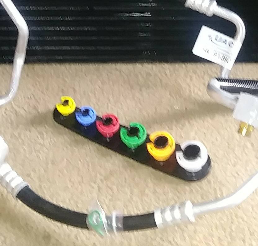

We replaced everything online except the compressor on mine it's a 94 4.0
