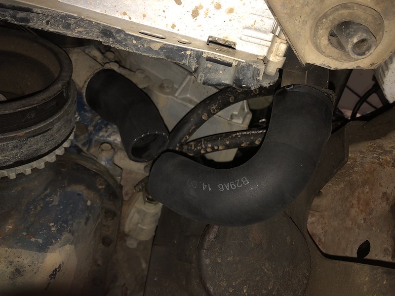

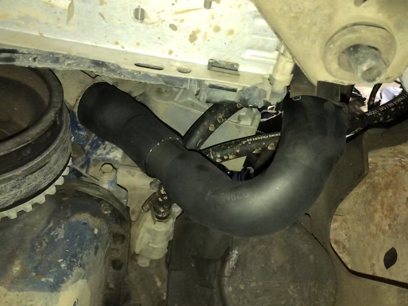

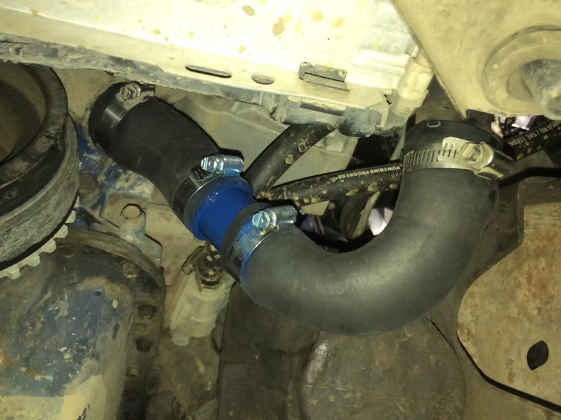

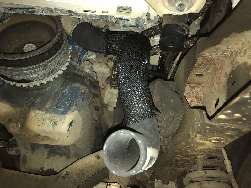

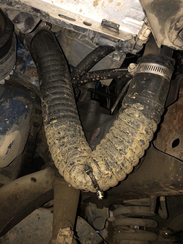

Step Thirteen: Cooling system
Install your fan/shroud of choice and then set the radiator in. I used a flex hose for the bottom hose.
My trimmed Explorer upper hose:
