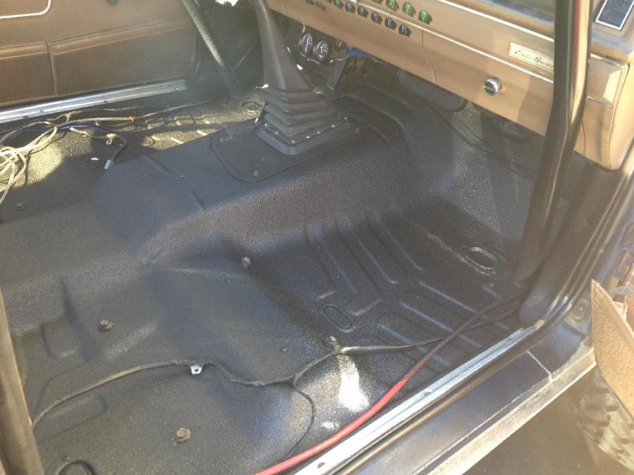

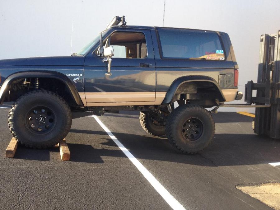

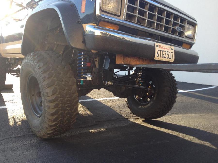

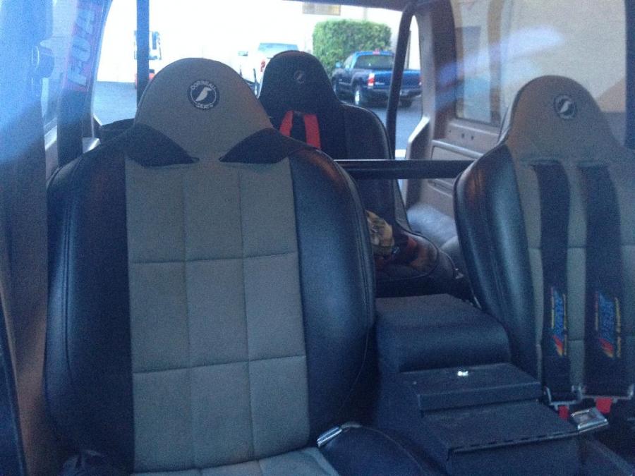

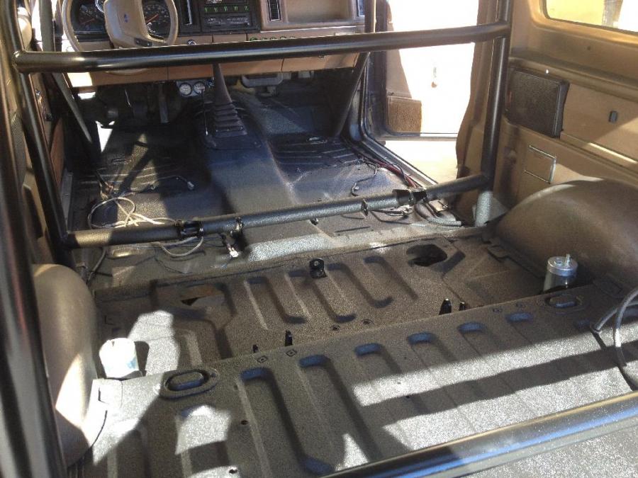

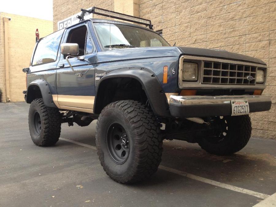

Hi, just thought I'd share my 86 bronco 2 build, feel free to give any suggestions or ask any questions.
Not sure if the pics are working yet, but they will be up soon if not already.
So, I have been trying to build a trail/desert vehicle, and this is what I have so far.
Started with an 86 bronco 2 STOCK
Rather then state every turn the rig has taken, I'll just go ahead with what it is to this date...
86 bronco 2
4.0 ohv, ported polished smog eliminate ecu, headers wrapped, cully ballanced.
M50d Trans
Bw1350 transfer case
Built wrangler drive shaft

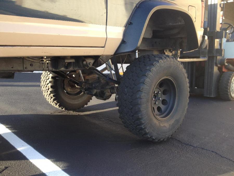

8.8 rear end, from. 96 explorer 4.56 gears and true trac
D35 from 93 explorer with 4.56 gears, true trac

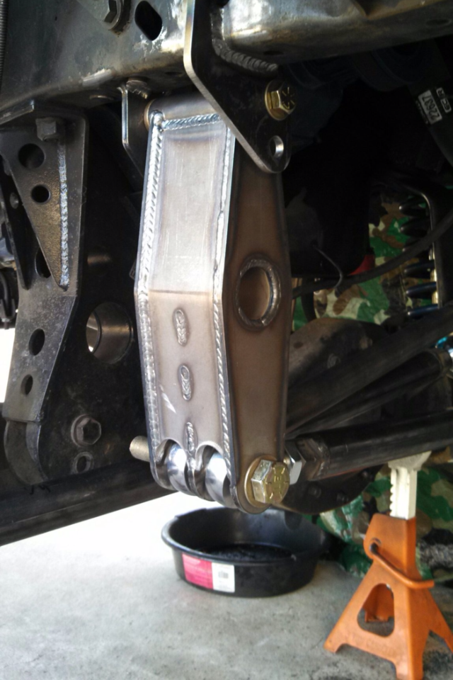

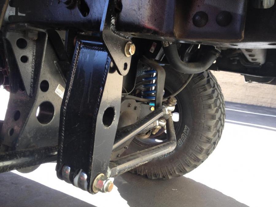

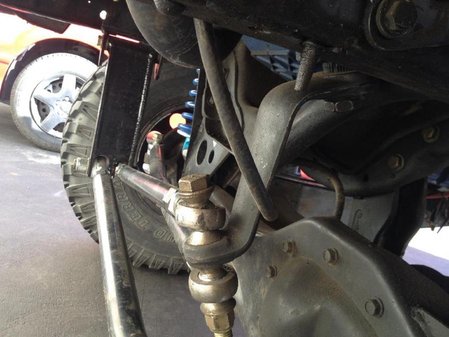

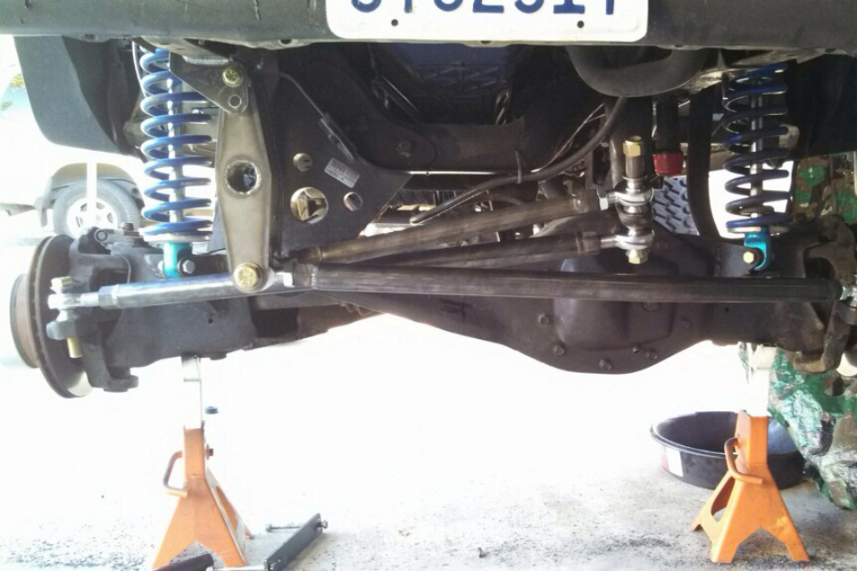

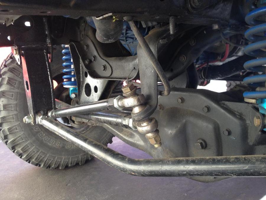

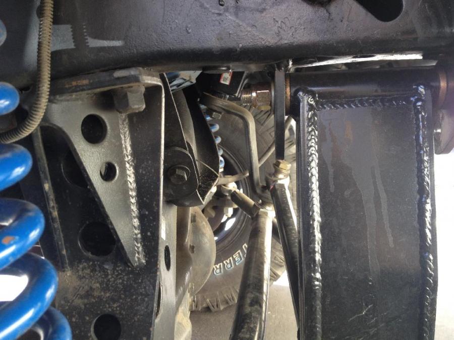

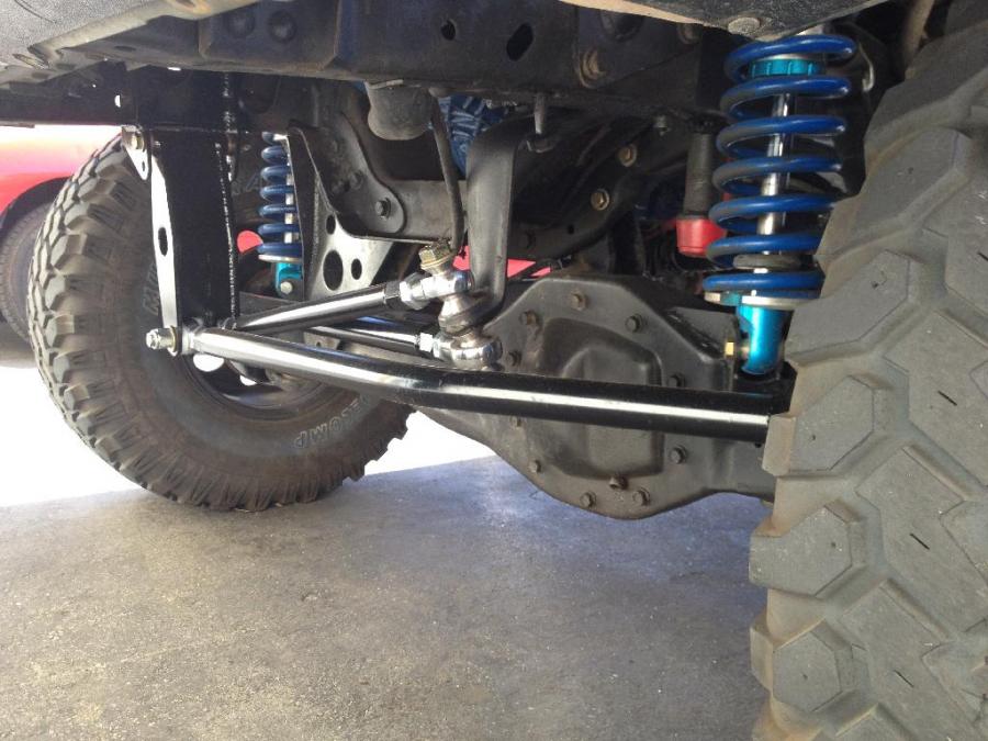

Sky jacker front arms and cross member
Skyjacker 4inch lift soft ride reqr springs with beltech shackles
Shocks up front:
12" king 2.5 dual rate coilovers with resi
Giant motorsports shock hoop
2.0 FOA bumps
Strapped at 16" of four wheel drive travel

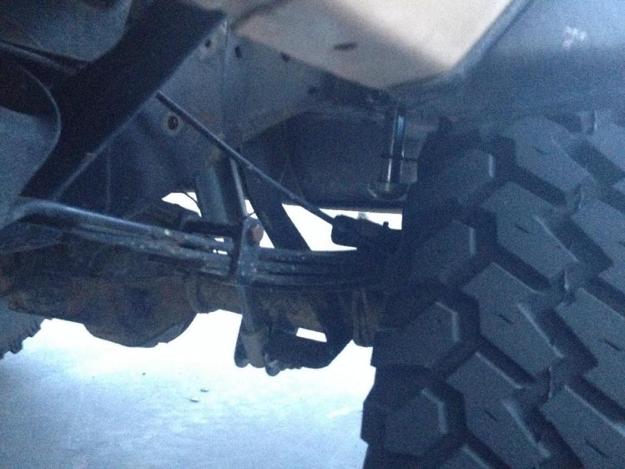

Rear suspention:
14" FOA 2.5 remote resi
2.5 foa bump
Strapped at 13" travel
Steering:
Stock box and pump
Single swing set with hiem joints all around
Exterior:
Bushwhacker fender flares
Stock tire carrier
40" LED light bar

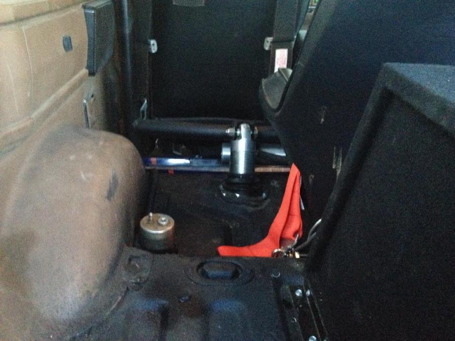

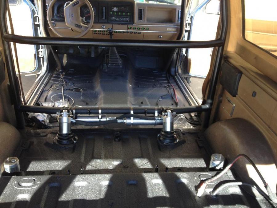

Interior:

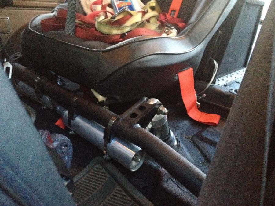

Full roll cage
Rear shock hoop
3 seater w/5 point harnesses all around
12" sub/amp
Smitty build center consul with seat heater switch
Raptor liner on full tub
I'm sure I'm missing a lot, but this is the most of it, if you have any questions or suggestions feel free to let me know.
