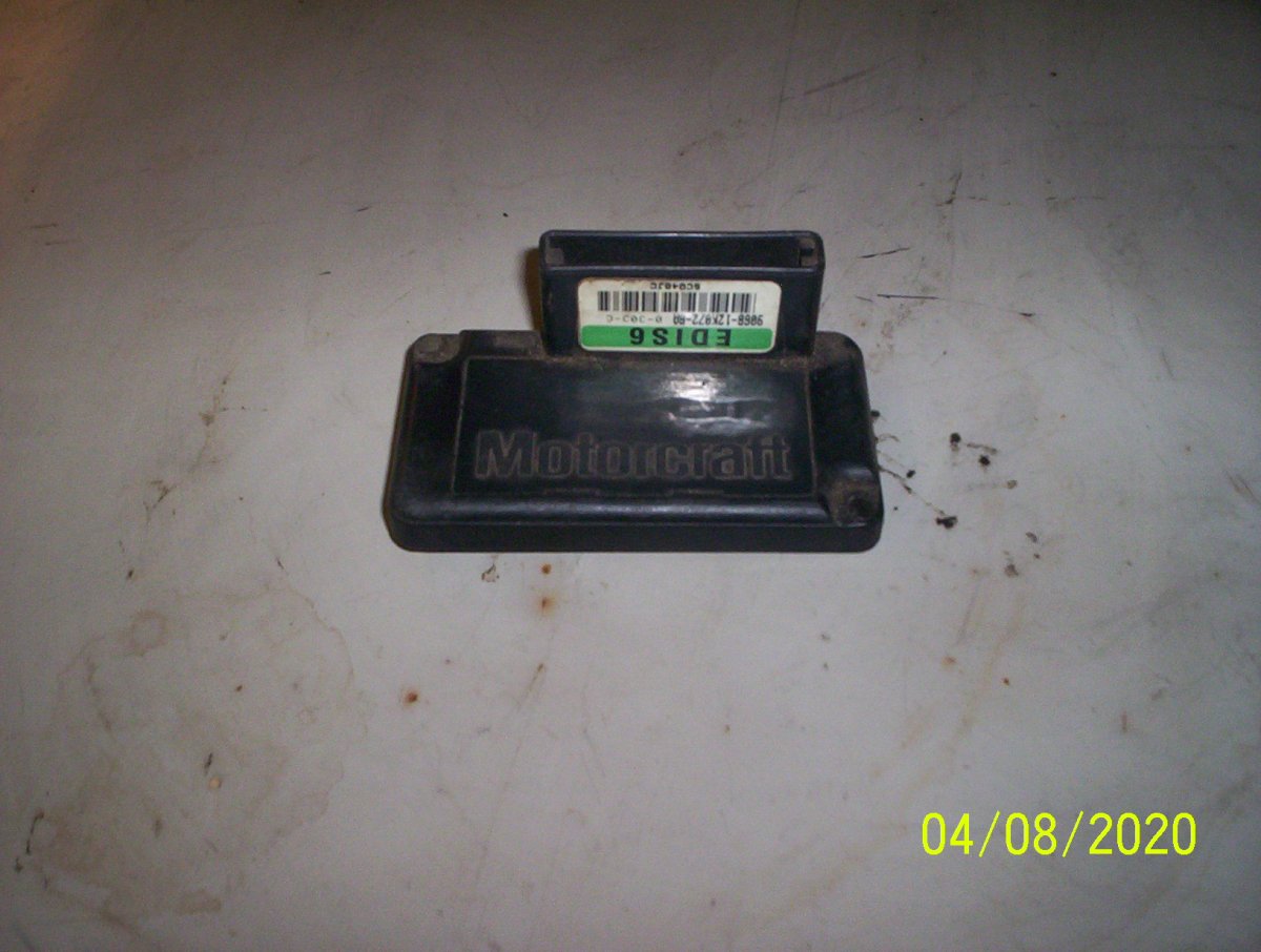

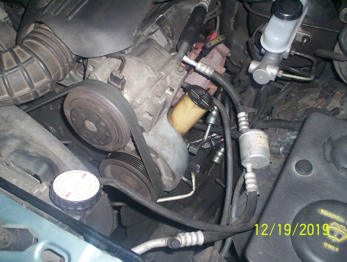

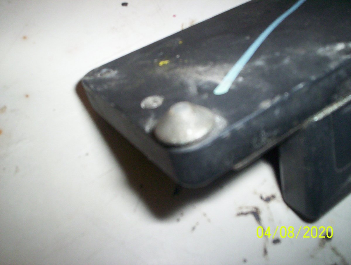

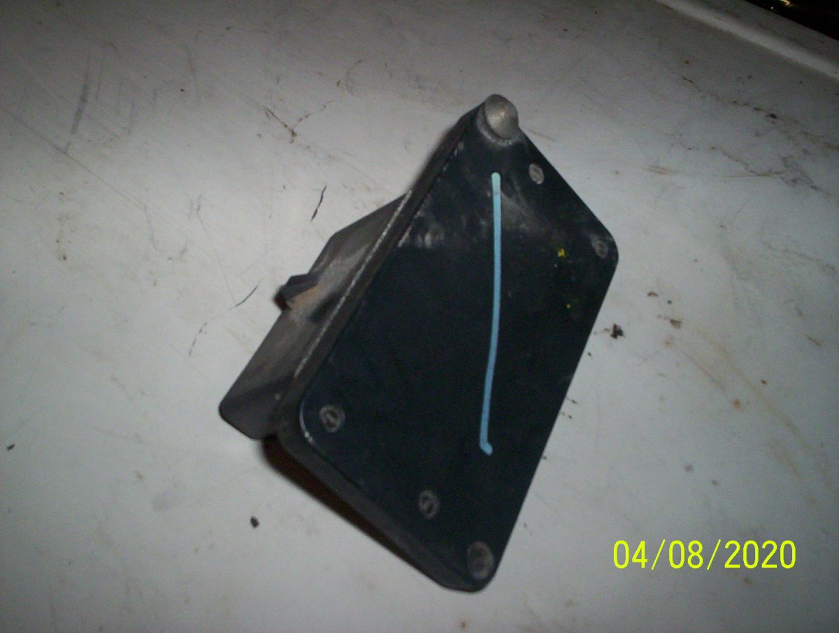

I was talking to a guy that told me If your having all sorts of problem time to check the power control module the thing on the core support next to the battery
25,290
8,290
The above is the Spark control module, an EDIS-6 use for 4.0l OHV
They rarely have issues, but can be damaged if there is a front end collision, as said they are located on the rad support, often on the front side for better cooling
And after a repair of the front end they may not have been replaced
