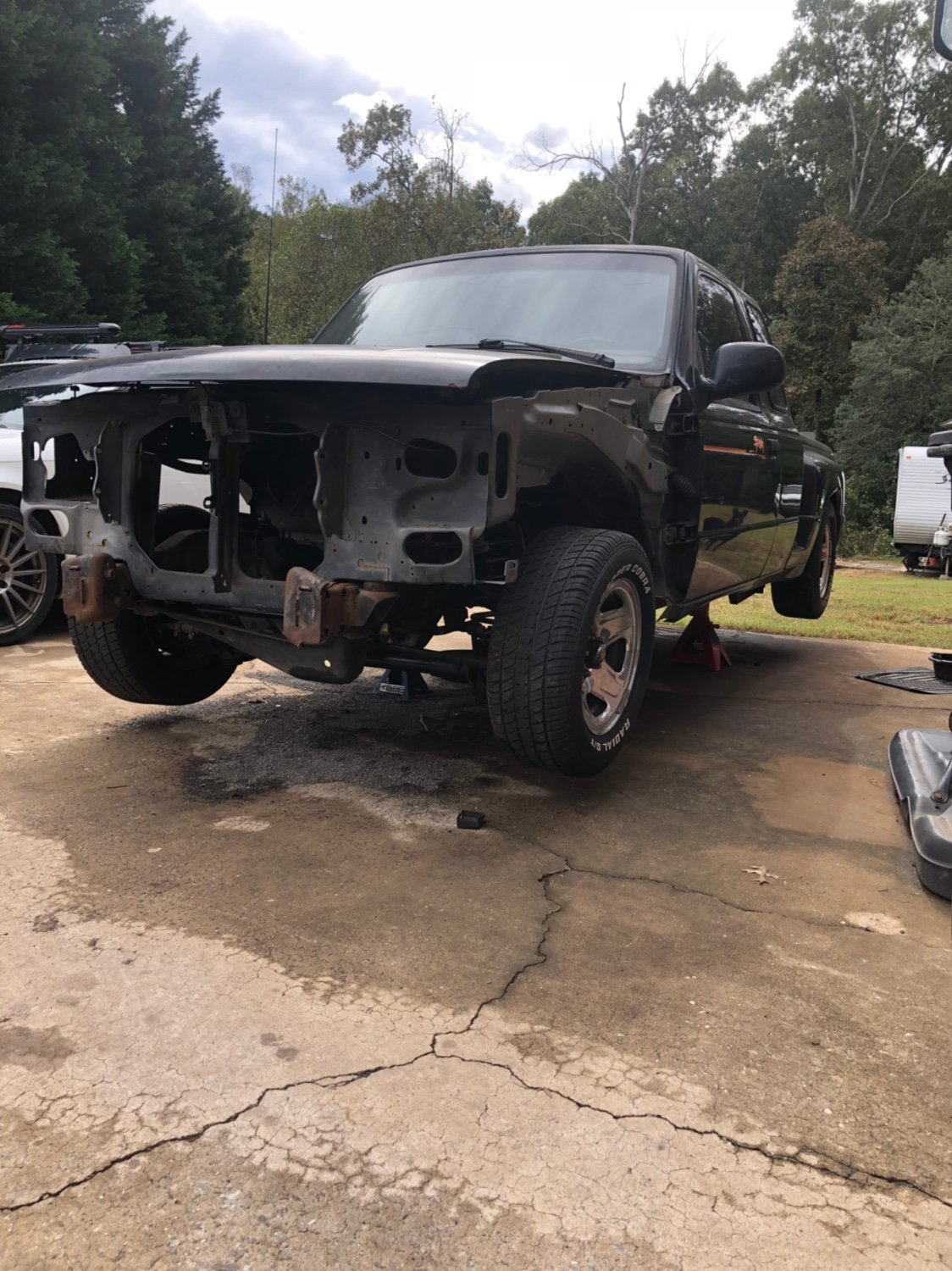

I wanna do the same thing I’ve got my truck torn down right now. I live in North Carolina right outside mooresville and there’s a race car surplus parts store that sells everything you could think of. I’m gonna put truck arms in the back with coil overs and I’m stuck trying to figure out what to do about the front. Really wanna do a arms but haven’t figured out how to go about it yet or what parts to use.

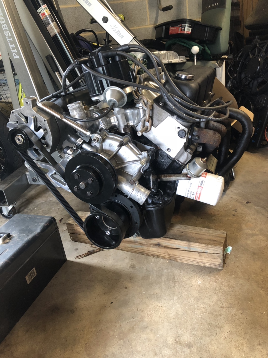

Got a 302 with afr heads and t5 with all the goodies to put it in after I figure out the rest of suspension.

Would be nice to have that but I think I’m just gonna fab up my own a arm kit. I’m a welder/fabricator and have a full machine shop at my disposal. In the next few weeks I will have more info and pics.
