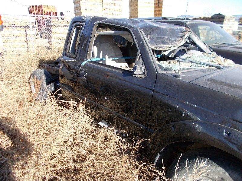

Hi everyone, I've got a multi part project im going to be starting soon but i couldnt find the appropriate category to post it in.
I purchased a 1998 Mazda b4000 with a 4L v6 and auto 5 speed trans that is 2wd, a buddy rolled his 2009 ranger 4wd that also has a 4L engine and auto trans.
Being as im in Canada, we have lovely winters (hate winter) but i need 4wd.
Does anyone know if my 98 cab and box will bolt to the 09 frame?
The next part is wiring compatibility, the 09 ranger has a push button transfer case so im wondering how much different the trucks wiring harness is going to be... im hoping to be able to just wiring the transfer case to a dash switch or something in my 98 cab.
I know some of you are gonna say "just buy a 4wd truck then", well if i could afford one of the many overpriced trucks i would have already... i like doing things the hard way ha-ha!
The secondary project is going to be making the 2 trucks into a single 6x6... but thats for a later project.

The 98 body should bolt to the 09 frame with minimal issues.
Frankly, the easiest solution to all of your wiring problems, and there will be many if you want to use the later (more powerful) 4.0, or the push button 4x4, your best bet is to swap the dash and ALL the wiring from the 09.
It will add a few steps, but it is doable.
The simpler, but not necessarily easier, solution would be a manual transfer case.

the newer engine would be great but the rolled trucks engine is toast, fully locked up from when it rolled over so i would be using the 98's engine.

Is it actually mechanically locked? Of is there just oil in the cylinders? Pull the plugs and see if it turns then. The rollover switch should have killed the engine so it wouldn't continue running upside down. I think you have to manually reset it as well? Otherwise the engine won't run either.
In theory it should. In practice, my '98 was ticking over still with shiny side down. And didn't stop until I turned off the key. And the 3.0 was locked solid when it restored to rubber side down. :(
What part of Alberta? I currently have a Ranger project which is 6x2 and easing its way to 6x4, eventually to 6x6. There may be some advantage to learning from each others mistakes.
Pulling large amounts of the wiring from the '09 is advantageous, even if you don't wind up using the '09 engine.
Then the most feasible solution is to try and find a manual transfer case.
These are, unfortunately, somewhat integrated systems, which will make retrofitting the e-shift 4x4 into the 98's systems nearly impossible. It can be done, but it is one of those things, if you can do it you will just sit down with the books and do it. If you have to ask how you probably don't have the required skill level.

Captain Ledd - plugs are out of the engine and its totally locked up, buddy says it kept running while he was upside down till it just quit.
don4331 - i'm in medicine hat, alberta only 3hrs from you. the 6x6 idea has been in my head for a while now. ive built everything from race cars to mud trucks but i usually stay away from fuel injected stuff haha.
adsm08 - i was thinking the same thing about the manual t case, i'm sure theres a junk yard around that has one.
if its a 1354....i would rob a system from a earlier truck....preferably obd1 from a u pull junkyard....where i shop for 10-20 bux. 15 bux for the motor. unless the motor looked fresh i may leave it.
just get all the wiring, switches and control module....
amazon a dorman brand new no core motor for 70 bux and run with it.
getting a low mile manual case will be hard to beat that price.
