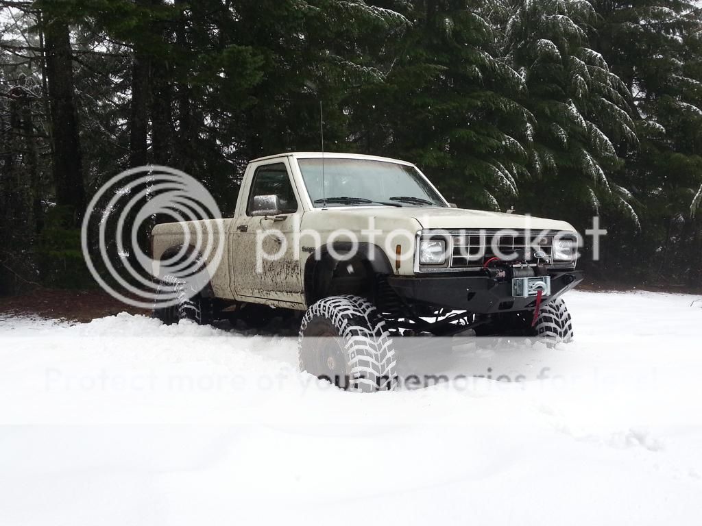

Here is my 1986 Ranger I bought a couple years ago. It was stock and broken. Had a broken rear axle and the fuel filter was clogged. I realized that the stock Ranger wasn't going to work for me. I began by replacing the rear axle and drove it for a couple months.
Front Axle
It was about time to lift the front and decided to go against TTB and go with a solid axle. I swapped in a full width Dana 44 out of a '77 F-150. I used the coil setup but with 4.5" lift EB coils. I extended the stock Radius arms approximately 12" and used 1.25" Heim joints at the ends for better flex. I built a cross-member to mount the radius arms to. I geared the front axle with 5.13's and a Spartan Locker. I used Chevy 1-ton steering set and tie rod ends on the steering and swapped the steering about the knuckle instead of below. I built the track bar and track bar mounts on the axle and frame itself and used heim joints.
Rear Axle
Since I was done with the front axle I decided to finish the rear. I picked up an 8.8 out of a early 90's F-150 and swapped it in. I moved the leaf spring mounts inward to accommodate the narrow width of the Ranger vs F-150. I also used Chevy 63" leaf springs to lift the truck and I got a cheap set of Belltech 6400 knock-offs to further lift the truck. I geared the axle with a set of 5.13's and a Spartan Locker. I finished the axle off with a 3/8" thick diff cover from RuffStuff.
The old 2.3 I had in the truck was slow. I needed more power but didn't want a lot of weight. I picked up a whole running TurboCoupe for $500 and swapped the engine in. The truck has a lot more power since the turbo swap and it didn't add very much weight.
Body
I bought a set of 4.5" wide universal Fender flares from Pacer and put them on my truck after cutting fenders. I like how the flares look and they are flexible and wont break. I bought a bumper off of Craigslist and made it fit the truck. I am using a Smittybilt XRC8 winch. I am running 35" Mickey Thompson Baja Claws on 15"x8" Black Cragar wheels.
Here is the truck...

This truck is sweet. Where was that first picture taken?
