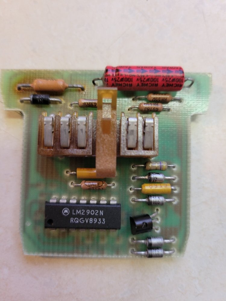

My float was brass and had a hole, so I replaced the whole fuel pump unit, but it still didn't work. I checked the resistance from the sender to the instrument cluster, and it was OK at 15 to 147 ohms. I also tried the tape and jumper method, but that did not work. I removed the SLOSH board and took it to work, where I applied power to it and injected about 50 ohms, but I only got 14.7 ohms out of it. I then discovered a brand-new SLOSH board on eBay, which I couldn't believe, so I ordered it. While waiting for the new board, I found a used capacitor in our capacitor bins with the same specifications: 100 microfarads
Getting the fuel gauge to work!
at 60 volts. I swapped it for the original big red one, and that worked. Electrolytic capacitors of the older types do dry out and fail.
