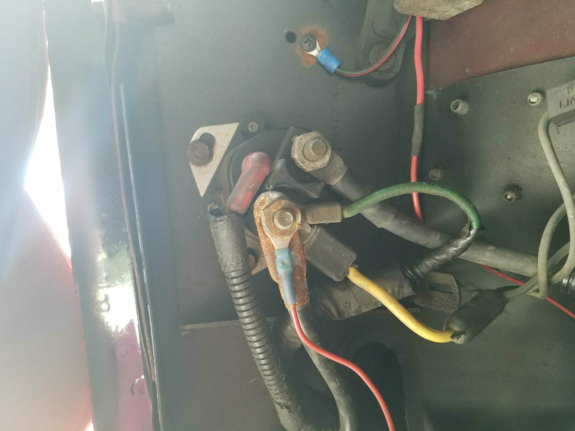

Left terminal:
Positive from the battery (shown here is the thick black wire i had to replace mine)
The yellow one runs to the main harness on the inner fender
GREEN this one runs to a another harness that runs toward the headlights next to the battery
(The little red one is for my cb i added)
Right terminal:
This runs to the back of the starter
Little red one on top:
This comes from the same harness as the green one next to the battery

Great pics of the wiring...although yours is a bit rusty...lol

I did not know there was a form for that and...and yeah their a little crusty but thats ohio for ya ill have to rub some die electric grease on em and all i have is my phone for internet right meow

Nice pics :)
Its a Starter RELAY, lol, my pet peeve
But every one calls it a starter solenoid
A solenoid creates motion when activated
A relay connects electrical circuits when activated
On some starter motors there is a hump and that IS a starter solenoid, when activated it pushes out the starter gear to engage the ring gear, so creates motion
So you make the call, on what that fender mounted unit is :)
