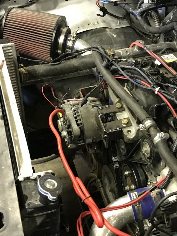

Alternator setup
This one is fairly simple. I ordered a 70 amp denso 1 wire alternator for $100 off ebay and began mocking it up. Heres what the brackets and alternator look like once in place. Keep in mind you will need to get a new 4 spline pulley for this alternator. The serpentine belt should be 1325mm in length and 4 spline. Go to an auto shop and ask them for that, they should be able to help you. Alternator pics!

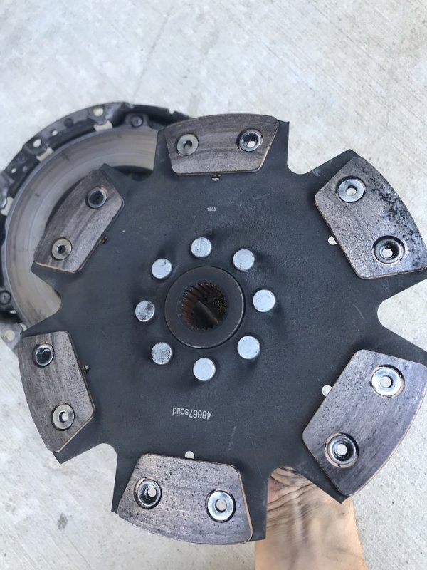

First off, the alternator. The little 70 amp 1 wire denso alternator I used went out within about 5-6 months and I needed something reliable. My idea was to but the stock duratec alternator back on, but there wasn't really room on either side of the motor. So I decided to make a bracket in front of the motor and run it backwards. It works just fine and puts out 14.5 volts at idle so I'm happy with that. Might look a bit sketchy but this is how ive been running it for months.
29067
29068

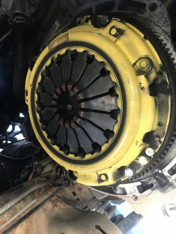

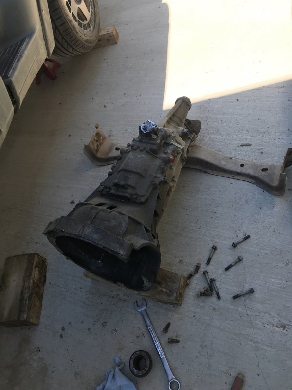

Aside from the alternator I haven't had any engine related issues. One issue I mentioned in this thread a few times before was just fixed today. The "clutch disengagement" issue, basically sometimes made a hard wall between gears for a split second randomly. No clue what caused this 100%, but when I pulled the trans today I found that the little snap ring on the input shaft that holds the throwout bearing in place wasn't sitting in its groove. That as well as the shims I put behind the slave cylinder were removed. I used to run a ClutchXperts stage 4 ranger clutch which was unsprung and a 6 puck disc. I changed out to their stage 2 organic sprung disc today and it shifts like brand new now. If you do this swap I would recommend at the very least running a ClutchXperts stage 2 clutch as its rated for just under 300 hp and torque. Its also a very affordable clutch in my opinion.
29069
29070
29072
